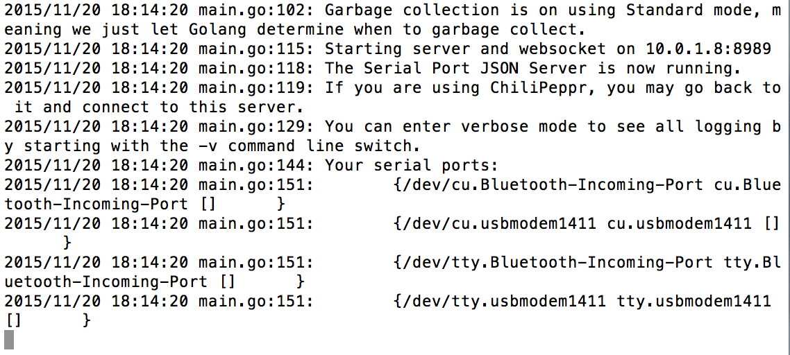

I recently bought a gshield and I am trying to upload the GRBL firmware on UNO however, when I press the “Program the board’s firmware” button, no window pops up - infact I see nothing happening…
This is what I have:
I know it may seem odd, but can you try this from the tinyg workspace at http://chilipeppr.com/tinyg and let me know if it works there. If it does then we need @Jarret_Luft to make a tiny tweak to allow the board programming.
That worked! Seemed odd but it did
