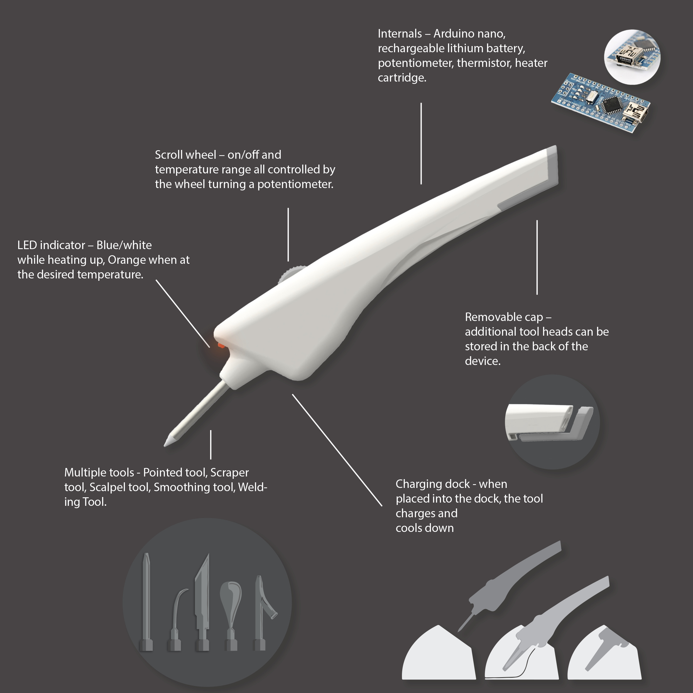

i’m wanting to develop a rechargeable heated tool with interchangeable tips for FDM clean up and post processing.
I was wondering if anyone currently uses any form of heated blade/tool in their print post processing and whether or not people have any recommendations on any aspect, be it: the design, the heating element (i’m thinking the same as in 5v 8w soldering irons), compromising the wireless aspect for a wired device if it means superior heating capabilities…literally any input on what people would want from this sort of tool.
for the interchangeable tips (as seen in the pic) i’m thinking: Pointed tool, Scraper tool, Scalpel tool, Smoothing tool, Welding Tool.
Cheers

Move the indicator light to the top in front of the thumbwheel switch. install into the former indicator lights slot a high brightness led that can light up the workspace. Use a magnetic sensor to indicate when the thing is sitting in its stand so it goes into power saving mode.
If you could incorporate a small blower tip into it, for precise heat gun work, that would be nice. If it could produce high airflow and quickly stop and start, and have the air come out already at a relatively precise temperature, even better.
@ThantiK that was pretty expensive. I’d love a cheaper one, maybe with a 3D printed body so you can change the grip.

What would the Arduino be used for?
@Selvakumaran_Ganesan the two main differences from this to the modify 3D design is the variable temperature, this is so the device can be set to just above the glass transition temperature for the material in use, meaning it’s not overly hot casing excessive melting and eventual carbonisation of the material on the tips…
In addition I plan on machining different tips, a wider smoothing tool and a hopefully a scalpel tool in which standard scalpel blades can be used.

@ThantiK I’m aware of a few, the retouch 3d being the main one… Pretty nice original design, now two years on and the beta product launching are nowhere near as nice but still £100+ … Are there any others worth noting? I’m not claiming the design as very original, I just want to make an attractive, inexpensive, ergonomic and easy to use system that doesn’t cost a fortune
