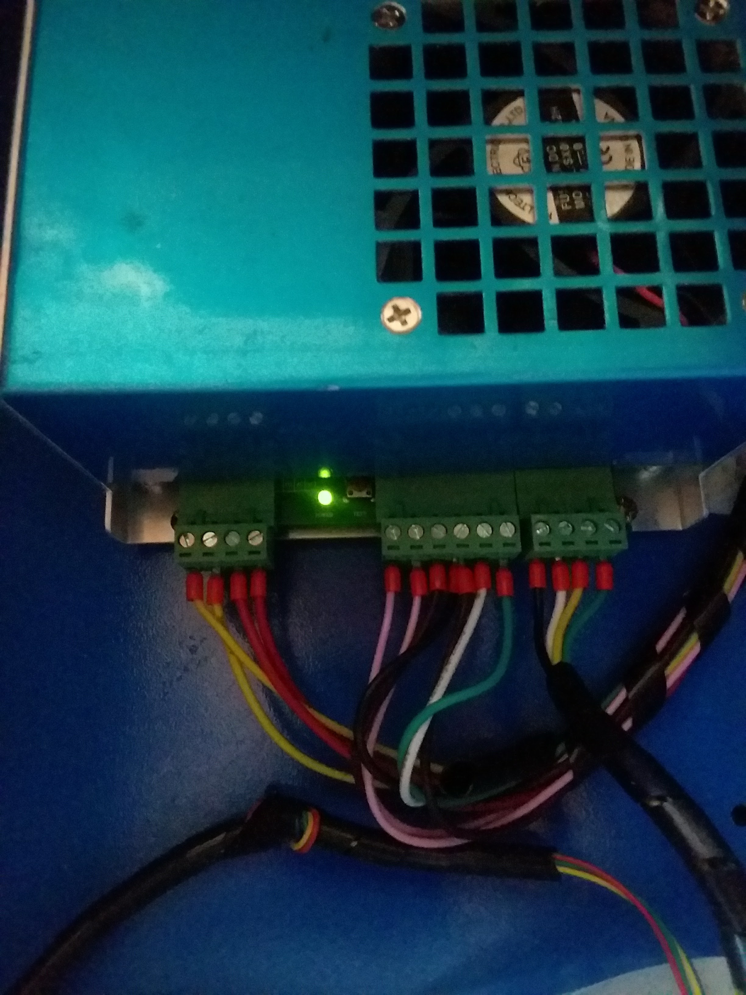

- Post picture of your LPS.
I will send a photo in the morning, when the machine is on, the Green light on the LPS is on, pushing the Test button does not do anything, Also the Fan in the LPS is not on ?? maybe that means something

@Lawrence_Kelley fan should be on if the 12v section of the supply is working. If the 12V is dead the LPS will not work, sounds like a bad supply.
Will continue when we see picture of supply…
@Lawrence_Kelley Whoops made a misteak, the fan runs on 24VDC not 12VDC. So this suggests the fan is bad or the 24V is not working.
Is it possible the fan is disconnected inside the supply?
I am somewhat perplexed in that if 24vdc was not working the machine would not be driving motors.
Are you handy with a DVM? We can measure the DC voltages on the LPS as a start but I expect they are ok?
