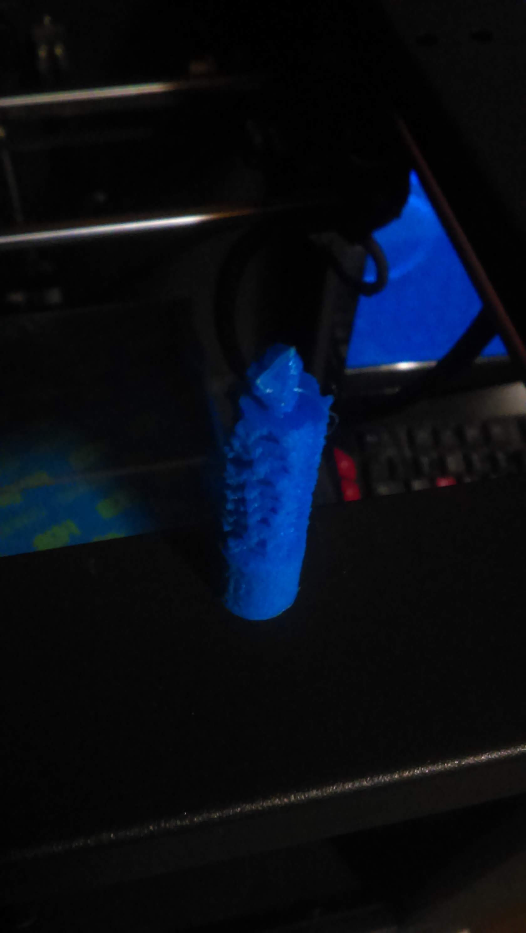

Hello all…sort of new to 3 d printing … had to pack the printer up for Christmas… and after getting it back up and running I have problems been working on it for 3 days and no luck …I’ve reinstalled the software .checked the belts and pulls .oiled the rails …any one with an idea ??? …it’s a threaded rod … …thanks

This is what iam getting

What was the layer height on that print in the picture you posted above? What temperature are you printing at and what type of filament?
Layer at 0.03 temp is 210 .and 3d solutech filament

Have you done this part before? At that thin of a layer and with a part area that small this might be a cooling issue or dwell time issue. That would explain the melted look. Do you have a part cooing fan? If so set it to turn on full. You might need to bump up the minimum time per layer so it can cool a little before you print the next one on top.
Another trick is to print two of them at the same time. Your print looks fine till the point that you print just on the bolt and then it starts to look melted and progressively gets worse.
It looks like you’re printing too hot. Check to make sure you’re printing as the same temp as before when using this filament. If you are then you should re-tune the PID for the hotend.
