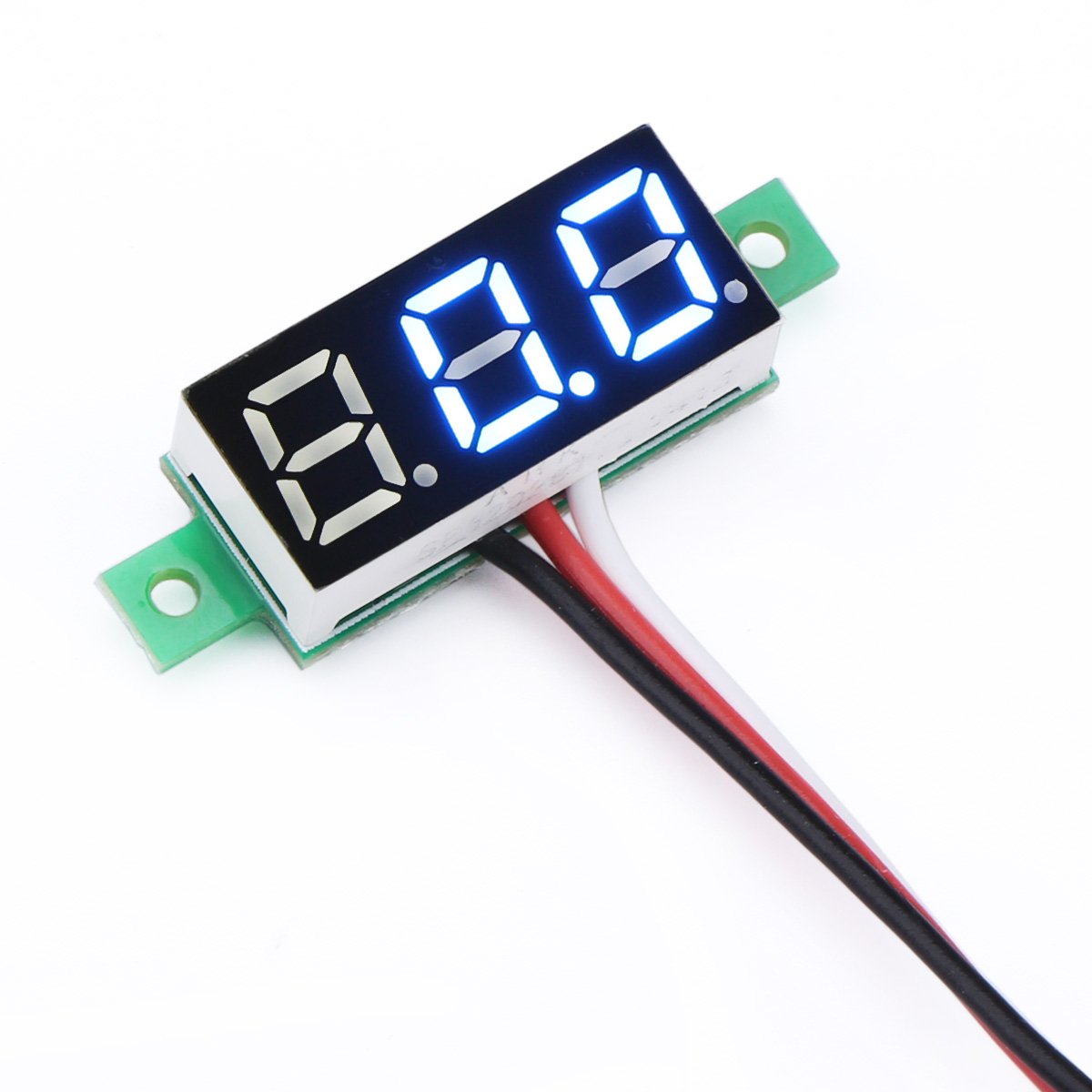

@donkjr @Nedman I’m thinking this phenomena may have a use to let you know when it’s time to change your water. Say an approperate digital voltage display with a probe in the water flow and to earth ground maybe??

The design problem may be that even at low current the voltage is high enough to fry an IC… I suspect the voltage is 100’s of volts.
Also we would have to find out empirically what are good and bad values.
A simple approach would be to try a voltage divider… with one of those cheap DVMs [which may need a battery]. Then again, you can get a DVM from HF for $10, or free on some holidays, stick it across the bucket to ground.
Here is a calculator: http://www.ohmslawcalculator.com/voltage-divider-calculator
