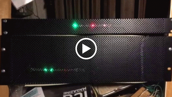

for my project, I’m looking to make a prop/fake rack server…you know, one of the units that you’d see in a server farm or networking room….rows of racks of iron doing their thing, and the only thing telling you they’r actually doing anything are all those cool BLINKENLICHTEN!
that’s what I’m trying to build….my idea right now is to populate a rack with 8 sets of 3ru & 1ru vented blanks, with some chunks of ws2811/12 lights behind them, simulating network/HDD activity lights….
I played around with some basic code that I’ve dug up, the MOST EXCELLENT wiki, and even have a pretty good prototype of one section of kit…but my gotcha now is that I’m positive that I have used a sledgehammer instead of a scalpel, leaving me stuck with just my single chunk of blinkies….(8px horiz, 5 vert & then another 8 horiz, between a 3ru & 1ru blank)
my questions are this:
  1. how to repeat my chunk of randomness to the next grouping of 21 pixels while maintaining randomness AND color groupings?
  2. am I doing my random assignments properly? I just have this gut feeling that I’m totally kludging my way thru this and there’s a more elegant solution to my ‘problem’….but I have NO programming experience unless you count Mrs Gerstein’s BASIC class in 1983
  3. to prove what a moron I am, I just realized when I went to paste in my code, that the sketch I based mine off of doesn’t even use fastLED…so my next question is, how could the fastLED library help in my situation?
usual caveats apply…thanks in advance for your help, sorry to be a bother, I hope I don’t appear too stupid & etc….etc…
