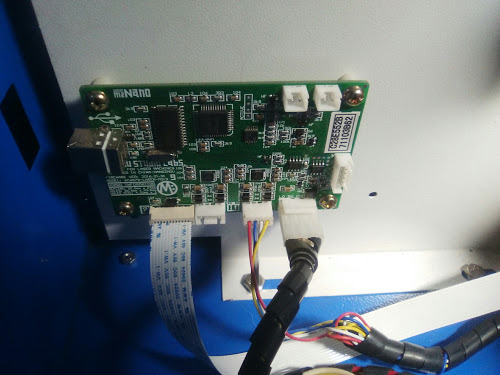

Tried that. Could this fella be the culprit? Something has gone wrong
@ian_humble ​ from experience and a couple of them users this most likely is : cleaning the optical endstops and / or check each solder joint on the cables
Thanks, I’ll look at these things.
