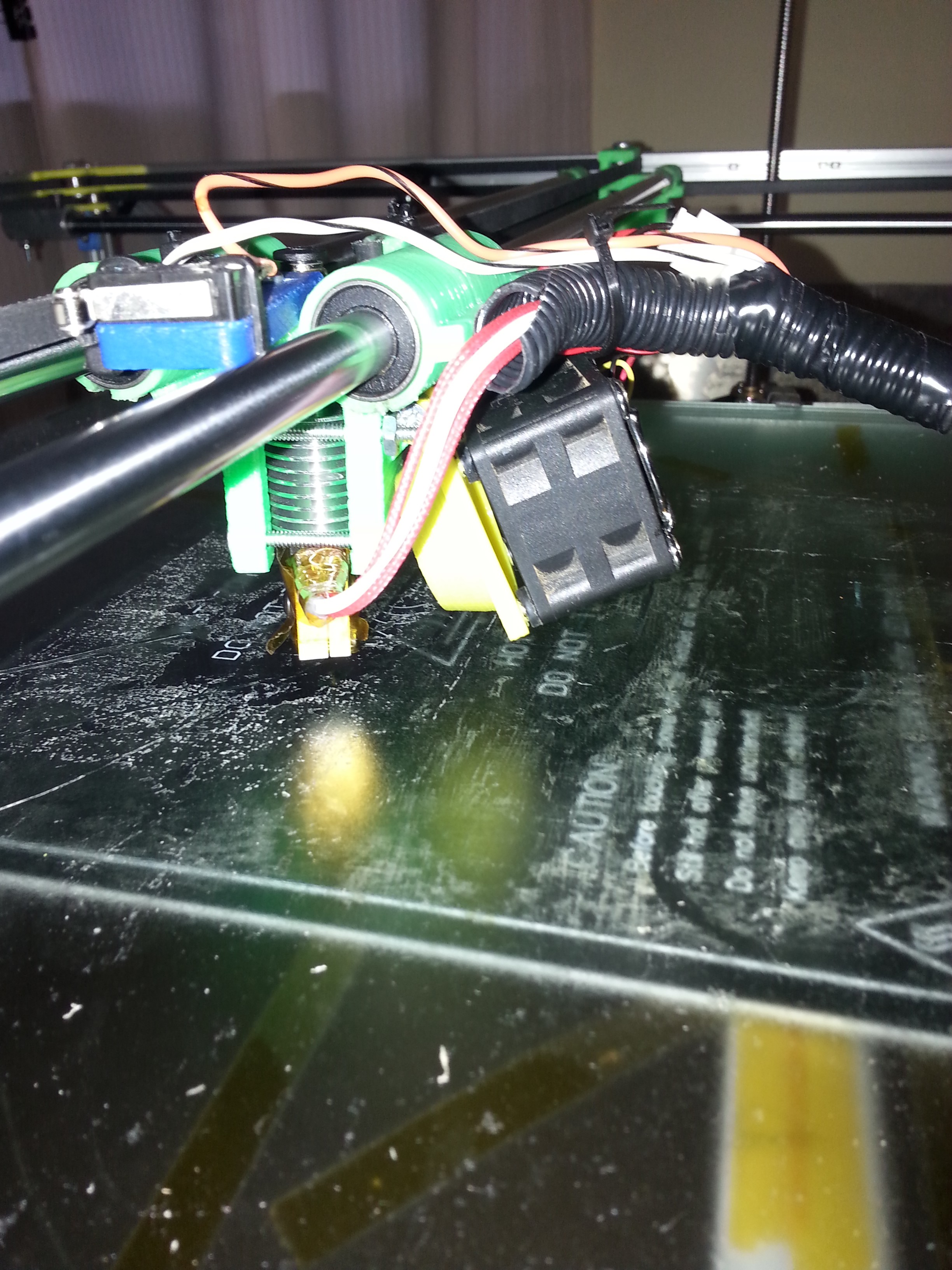

Hello, anybody use a volcano nozzle on the 3d printer.
What software do you use to generate the gcode and what setting to print it. My initial print layer it’s bad .can’t figure out what I do wrong. I try Cura or slicer , no luck.
Nozzle size used 1.2
Printer x y core
Board ramps1.4
Step driver Dr 8825
Power supply 12v 12amp

thank you for the input , i do have the kit of nozzle size from 0.2 to 1.2 so i will try with your setting.
@Bruce_Lunde yes, you right i have the same kind problem , initial print starts bad. i hope to fix the problem i have.

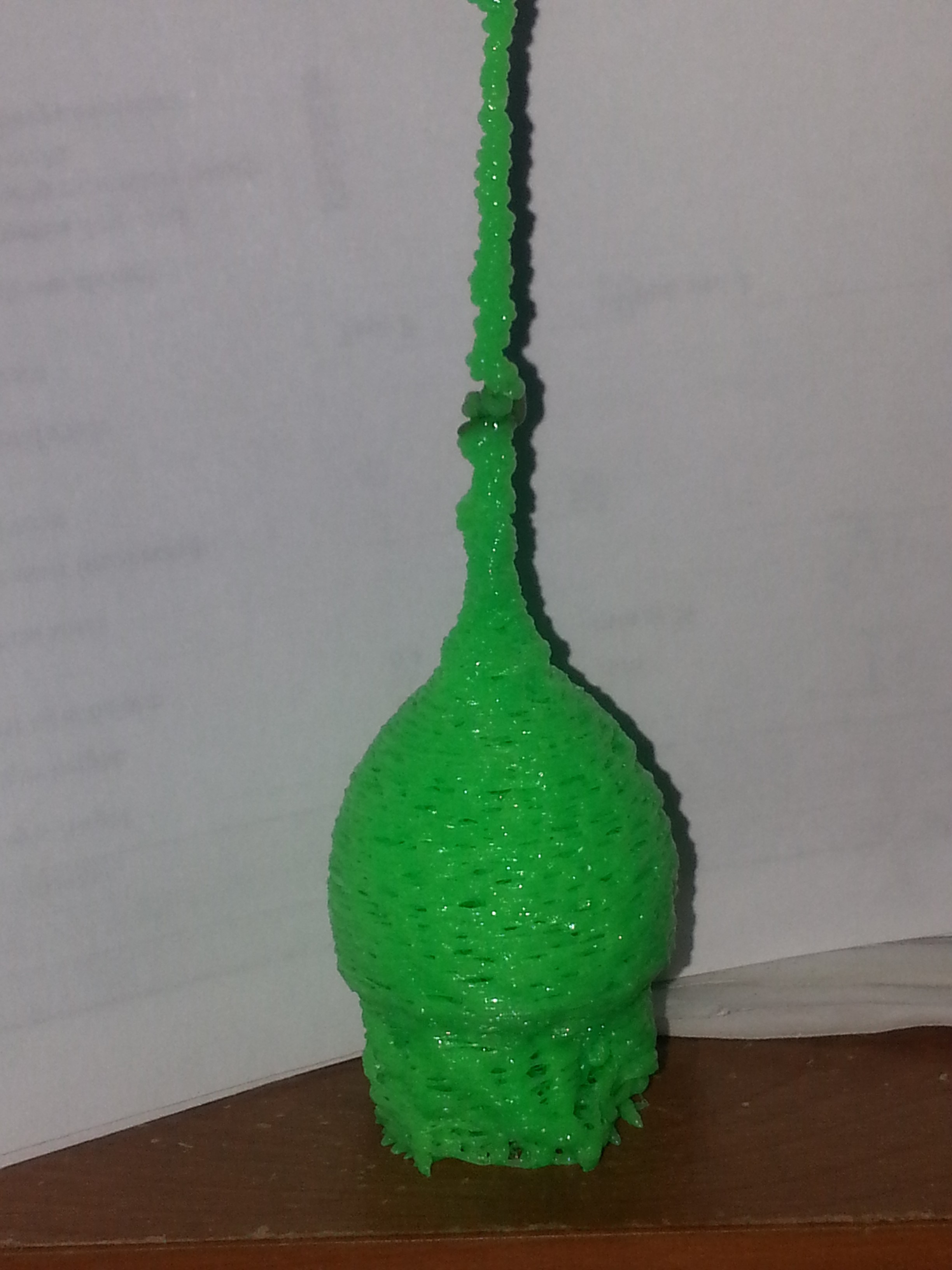

here a sample of top rocket printed in few minutes.
software use repetier-host , engine slicer Cura.
should i leave the feed rate to 100, i reduced to 80%, i forgot to turn the fan at halfway print( oops).the printed object its hard to crush ,infill at 20%
