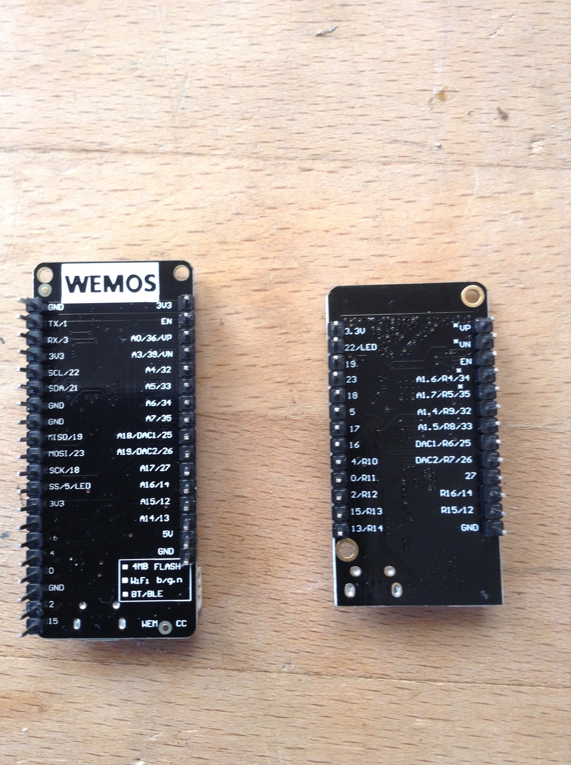

Hello, bad start here with simple fastled code on ESP32. I guess the problem comes from the board (see attached) but I don’t know what to do exactly. Despite many many tries leds are unexpectedly flashing for the left board (lolin32). And for the right board (lolin32 lite) I get a "A fatal error occured: time out waiting for packet header. Both code and ledstrip run good with a nodeMCU esp8266. Is there any issue with these 2 boards? Any help would be appreciated.

okay, thx :slight_smile: Unfortunately no success with 3.1.8 nor 3.1.6 nor @Yves_BAZIN 16 parallel output strips fork (which I want to use !). I have to look deeper. Possibly a corrupted board or something … these do not seem to be real Wemos: https://wiki.wemos.cc/products:lolin32:lolin32
