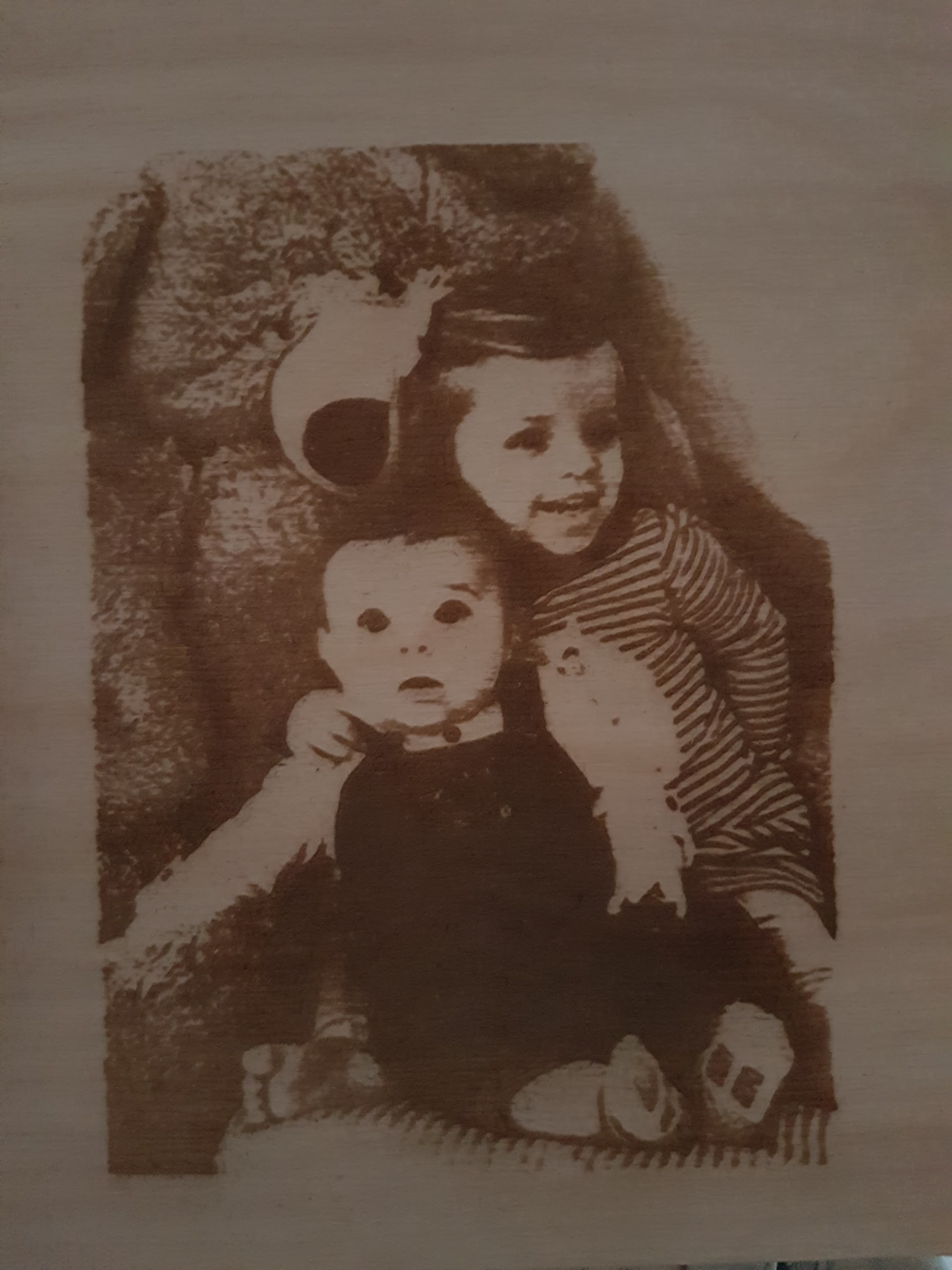

I have posted a picture of my k40 and of a raster image (still need to tweak the settings).
