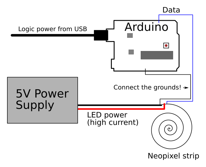

Hello, can anyone help me? I have WS2812B connected as shown below. I have working animations, however they all are red, green color is barely visible and there is no blue color at all(led strip shows nothing at all), as a power supply I have 4 AA batteries, each 1.2 V connected in series (4.8V), I have 30 leds, im using NODEMCU v3 to controll it. I cannot wrap my head as to what could be the cause of it.

Sounds like a power issue. Do you have a proper 5V power supply you can try? You might also try lowering the brightness, and powering the LEDs from the Arduino’s 5V pin (with the brightness turned way down).
@Jason_Coon I don’t have 5V power supply but I will try and get one and I only have my nodemcu aviable, but I will try your suggestions. I also red on the internet that this might be a power issue, just don’t know how to test it, have to finally buy voltmeter.
@maris_ancans ah, sorry, missed that you’re using a NodeMCU, saw “Arduino” in the drawing.
For the NodeMCU, you should be able to use the VIN pin to power the LEDs. This should be 5V from the USB cable.
