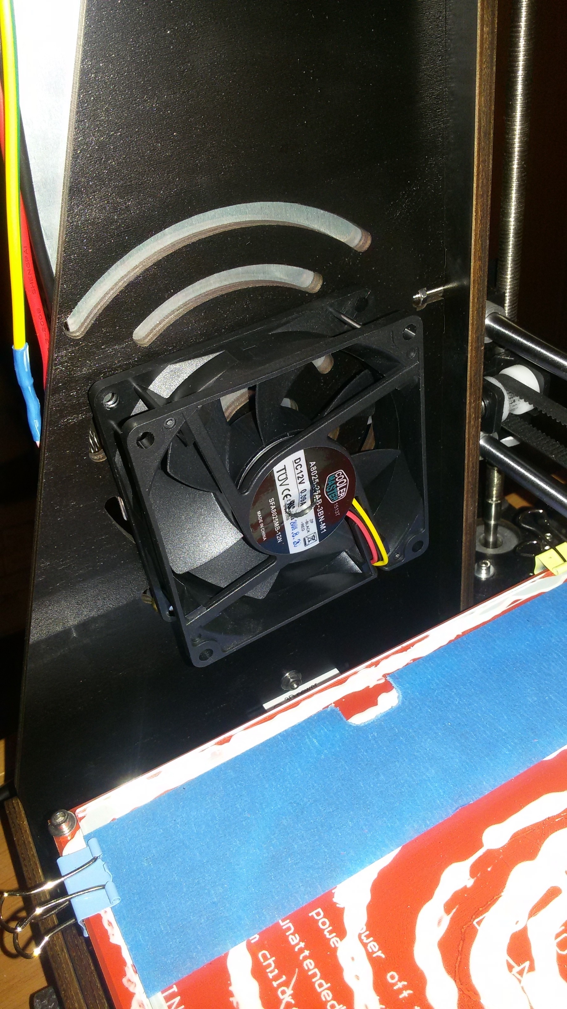

Hello community! Here is my 80x80 bed fan that I attached to the output
Hello community!
Here is my 80x80 bed fan that I attached to the output of the second extruder.
In practice instead of having the standard outputs EEB (Hotend, Hotend, bed) I modified them with EFB (Hotend, Fan, Bed) configuration.
I like to share my firmware modification at this link: https://github.com/Tungsteno74/Marlin/pull/2
After said that i’d like to know if someone use a bed fan and have some improvement on printing.
Thanks!
Originally shared by Valerio Baldereschi
Finalmente ho aggiunto la ventola di raffreddamento per il piatto di stampa!
Questa carissima aggiunta mi permette di diminuire drasticamente i tempi di raffreddamento e di prevenire la deformazione del pezzo mentre si raffredda (in teoria su ogni materiale ma per il momento ho provato solo con il PLA).
