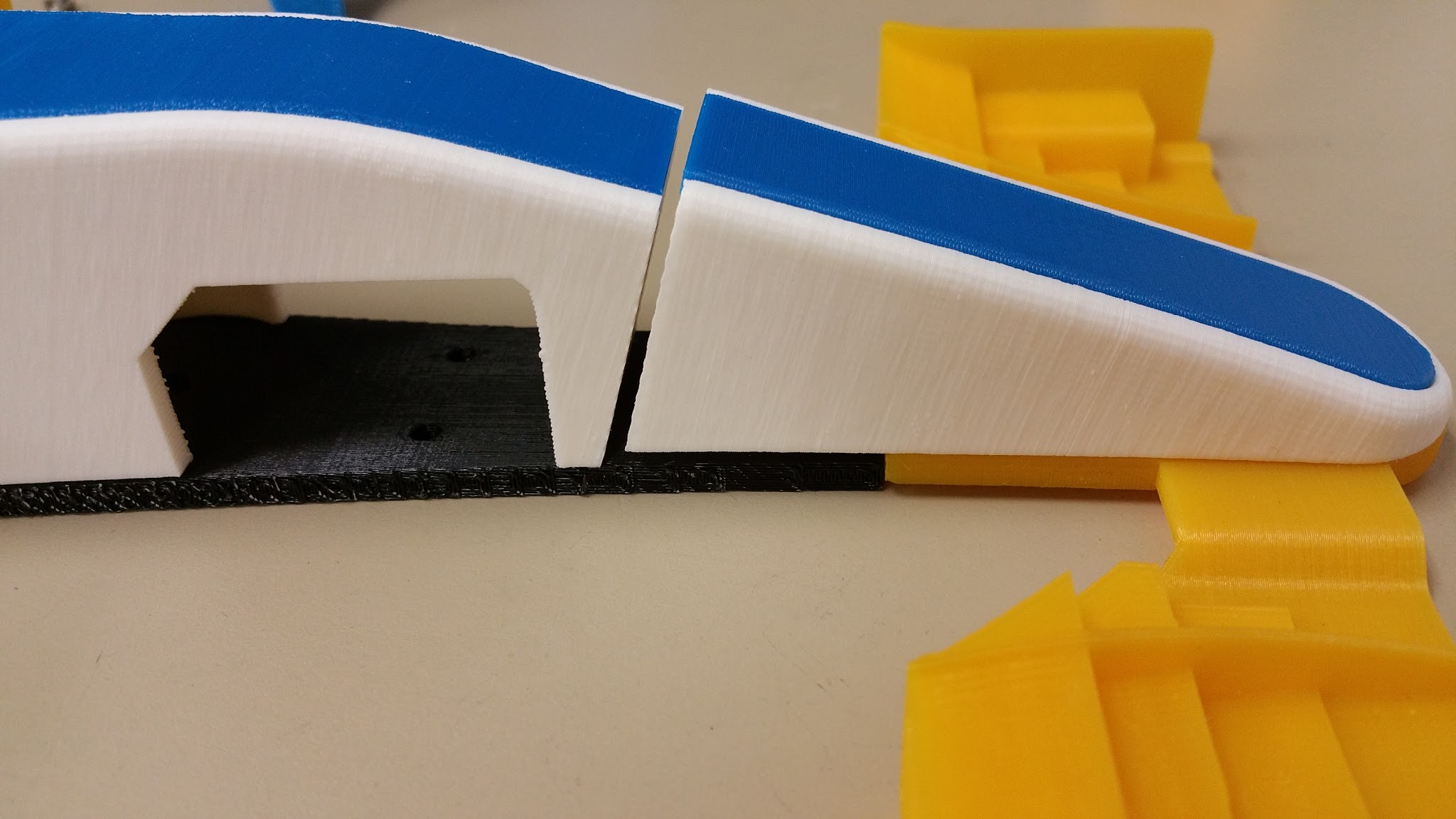

Hello @Daniel_Noree and everyone, I downloaded the OPENRC F1 stl files on thingiverse and printed the Dual_Extr files but I noticed there is a problem with the Front Spoiler, it’s a bit big (5mm or so) In order for all the screw holes to line up, the front spoiler needs to be shorten. Thanks again for creating this model!
I’ve never seen that problem before. Usually there is a space in the nose where you can slide the part back. Is there any adjustment available on your part?
I figured out what’s the problem, I originally downloaded the all stl’s from Pinshape back in 2015 and printed the Front and Rear Chassis. The dimension of the Front Chassis and Front Spoiler are different the ones from Thingiverse by 5mm. Ill just have to saw off a little bit on my front chassis to fit everything. Thanks!
