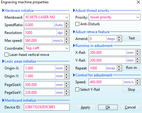

Stock controller refers to the control board that came with the machine. Sounds like you are using the stock control board with corellaser. I forget what causes this problem but it’s one of the settings. The following pics have what your settings should be. The device ID is unique to your machine and is printed on the control board in the laser.

THANK YOU VERY MUCH for the advice councils and your time.
