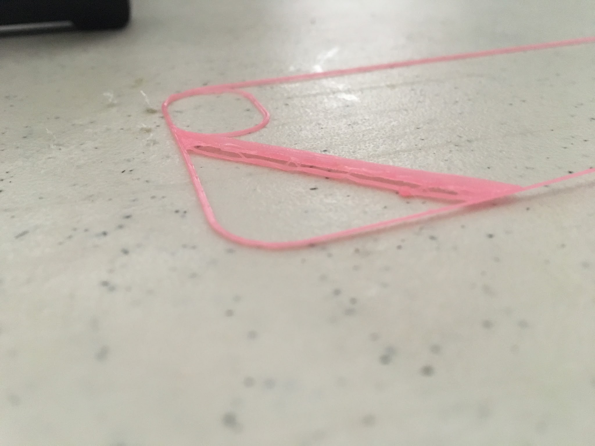

Hello everybody! I need help fixing my prints.
Hello everybody! I need help fixing my prints. When I print using PLA, there seems to be some tearing (not as in crying, but ripping) across the print. Maybe it’s due to warping? I tried to lower my bed temperature to 50 C, then I increased my bed temperature to 60 C (it was originally 57 C) but nothing seems to be working. I then made sure my bed was leveled and it was. I have no clue why this is all of a sudden happening. Please help me!
It could be clogged nozzle. Or insufficient Z-height.
You could also try printing with a brim. Also make sure your bed is really clean.
+1 clean bed. Also, maybe printing too close: I’ve seen my stuff pop off like that when it’s trammed too closely. I usually run my pla prints with a bed of 60c, so your temps sound about right. May even need to up the temp on the filament, I’ve had pla range from 200-230.
