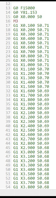

Hello everybody, new guy here. I recently added a l cheapo 3.5 to my 3d printer running a smoothieboard. After days of trying to wrap my head around the world of lasers I luckily ran across laserweb. Seems Like a perfect match for me but I am having an issue of no F command for G1 moves. I’m just trying to test out raster and I kept getting just an even grey. So started with tuning for a good black by dialing back the speed and noticed no change. Then came to find that the only F command was for G0. Manually changing that does effect both G0 and G1. This is all on ver 30420. Testing the same thing on older ver 30253 and all works fine. Glitch or did I screw something up?
Here is what I’m getting even after git pull. The only speed is the very first one to set travel moves. Changing the light or dark raster settings has no effect at all.

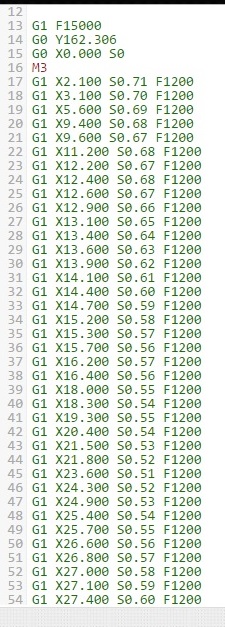

The 30253 created file cut successfully.

Sorry you seem to have misunderstood what I meant by my posts. I’m not arguing that you need to roll anything back as I’m sure any changes you make are for some short of improvement. All this coding is witchcraft to me so I was just showing examples of the issue I am having to make sure we are on the same page since you were unable to duplicate.
Very first thing I did today was a git pull but because of my inexperience I didn’t know to clear the cache. Also I didn’t notice your first comment about clearing the catch as it ended up in the middle of my posts. I have done a git pull plus cleared cache and I do now have a speed for G1 moves. I also noticed it takes much much longer to raster the same image now and at times freezing chrome. At this point my problem seems to be an isolated incident and my lack if knowledge requiring a greater degree of help seems to be annoying you. So feel free to just forget about it and I will see how future updates work out.
