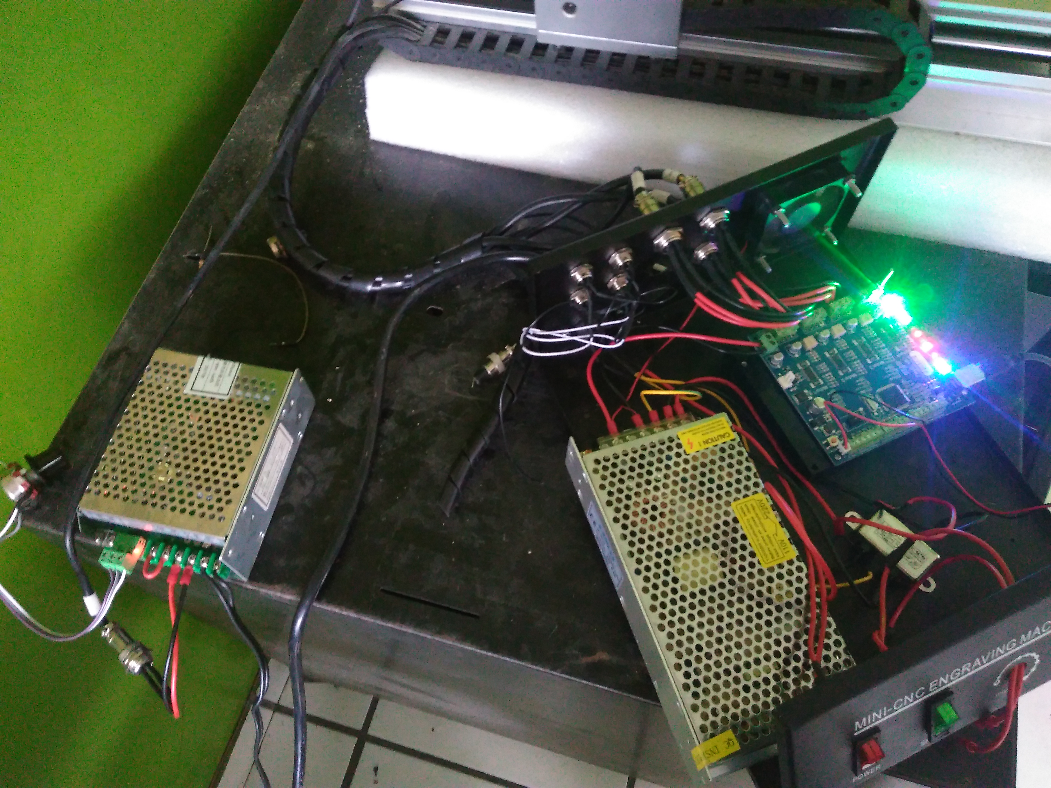

My problem is with the spindle. I control the spindle with the PWM driver it came when I first bought the CNC. when I am not running any gcode, I can move around X,Y,Z axis and the spindle also works . all work like it’s suppose to be. But when I try to run gcode (the chilipeppr logo, this was my first try on chilipeppr) it doesn’t works. But when I turn off the spindle , the machine can run the gcode. I am attaching a picture of the PWM control for the spindle.
I also dont know what is the little thing that is connect between them (I am attaching a couple of picture too).
Also noticed something, whenever I use the spindle , the light of the Mot1, Mot2 and Mot3 go on but the brightness is low. And when I only use the stepper motors without the spindle, the LEDs go on too but are more bright. I am attaching two pictures, one for each situations.

In addition you might check the power supply values when the spindle is energized. The dimming LEDs may be a clue that dc supplies are overloaded.

Are your motor LEDs “dim” when motor is running?
If so, dimming is normal. The LED is connected from one of the 4 field wires to ground(the A1 lead) When running, the voltage will statistically be positive or negative, hence dimmed. If the motor is at rest, the led may be hard on (bright) or off.
The Motor LED is NOT a logical “Motor is moving” Yes/No indicator.

@r.v.oscar9318 its still a little bit hard for me to see what your configuration is but let me try an provide some useful ideas:
  1. Your spindle motor is connected to your speed controller and you control the speed with the pot on the controller. There is NO connection from the speed controller to the TinyG?
  2. The TinyG will operate normally some times and other times it will stop but it only stops when the spindle motor is running. When you run it without the motor running it runs properly?
If #1 and #2 is true then I think you may have a ground loop between the TinyG’s supply and the spindle motor or noise injected to a control signal from the motors current.
  1. Best I can tell the spindle controller runs from AC and the supply and its output is not referenced to anything? The motor and the controller are electrically isolated from the TinyG, YES?
It looks like the motor wire is running in the harness with the other signals so you could also be getting noise from motor currents.
You can be also getting noise coupled into the ac power. I did not previously catch your question as to what the "… the little thing that is connect between them" is. Its an AC line noise filter.
  1. What other wires are in that same harness, stepper motors?
  2. Do you have end-stops connected? I don’t think so?
My guess is that the TinyG is getting reset from some noise source. Not helpful I know but it hard to see exactly how things are wired and what wires are near each other.
  1. When the TinyG stops what lights are ON other than the motor lights?
  2. How is the line filter connected in the AC circuit I cannot tell from the pictures (can you provide a drawing).
    If it were me I would start by connecting all the metal cases of the power supplies and the line filters ground to a common bolt using ring tongues. Do not daisy chain.
If that did not work I would tie the DC grounds of any power supply going to the TinyG to that same bolt.
I do not think that you can tie the gnd of the spindle motor to the same point as I do not know if it is connected in a HIGH or LOW side configuration.
You can try taking the motor cable out of the harness …
Noise problems are tough to find…
Another place is spindle noise on the serial data cable. I moved mine away from the spindle cable till I was able to buy a nice one with a ferrite ring.
