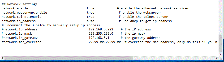

Hello everyone, I am running Smoothie in a k40 and I cannot seem to the LAN to work, in my config I have it set as (see picture) and when it turns on I get a crazy IP address. Any help please?

@Kelly_S Some routers in rare cases don’t like smoothieboard and DHCP does not work. In that case setting up a static IP should work.
Got it to work, it did’t use the address I gave it, probably because I kept dhcp to true, but it is now on the network.
You wanted to use a given IP address but left it commented out?
Nothing was commented out of the three settings in the static IP address. I am not sure what made it work for sure. I am just happy it is working. It is a stationary device and nothing is going to change in the foreseeable future.
