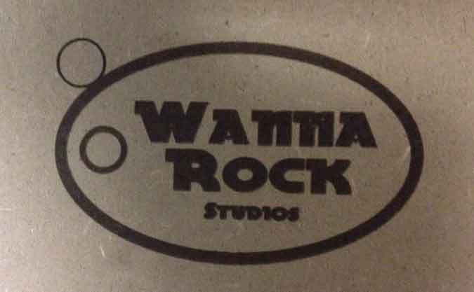

Hello everyone…i have a big problem with my K40 … i engrave my drawing…and it’s ok… when i select a part (layer) of the same drawing to cut it (an hole for keychain) the machine cut it starting to the top left point …as you can see in the pic…like it start again from the zero point…it happend with everything i try to cut (or engrave again) i can’t understand why! anyone can help me? i use Moshidraw 2014

the trick with the dot on top left works!!! …but it’s strange to fix the proportion issue with this “bug” …
