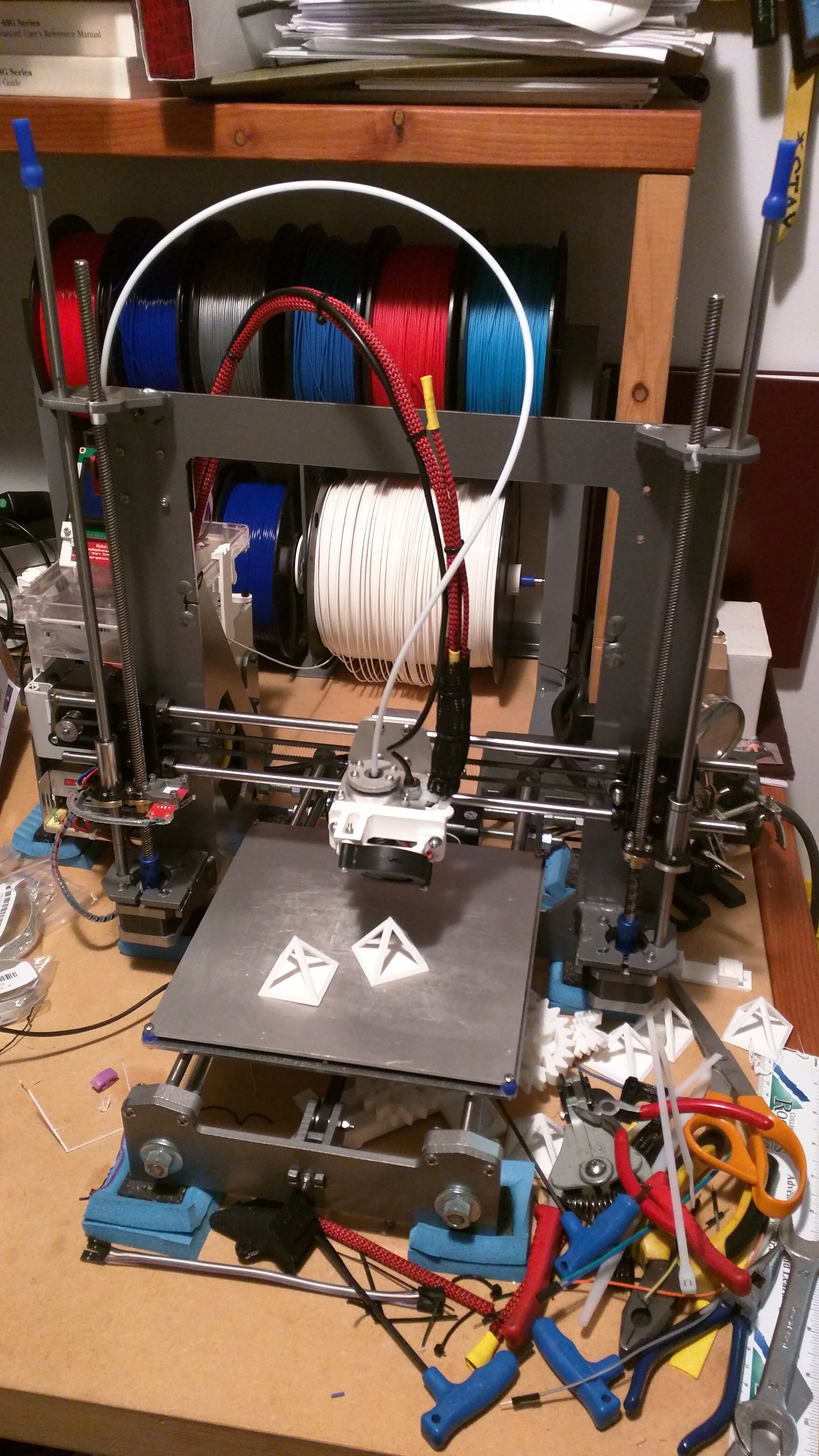

Here’s my latest blower cooling fan mount for my home printer. It’s sooo quiet. Now all I need to do is to get rid of the noisy fan in the power supply somehow. The rubber and steel motor isolators are amazing, too.
Thank, Jim
