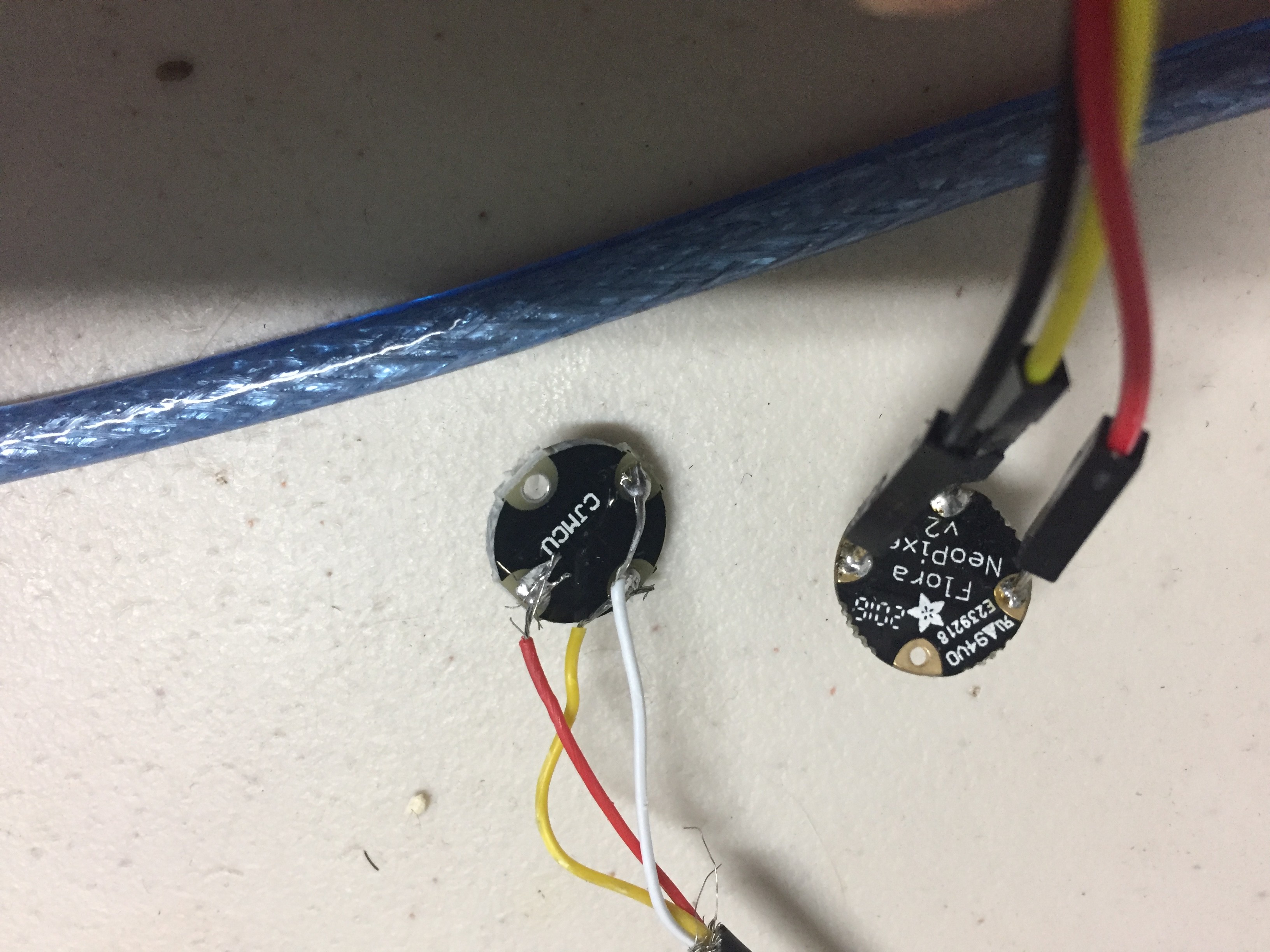

Switching the new pixels with old Flora ones to see if code is incorrect. (Photos 3 and 4: Left side is new pixel, right side is Adafruit’s pixel.) I get white color with the Adafruit ones and Red with new ones.

@Andrew_Tuline Don’t currently own any Nanos, but I did try skipping first pixel and connecting to the 2nd one; and also a single pixel (see photo 3 or 4) and I received the same results. Any idea as to why a Nano would behave any different if its the same Arduino code going in?
