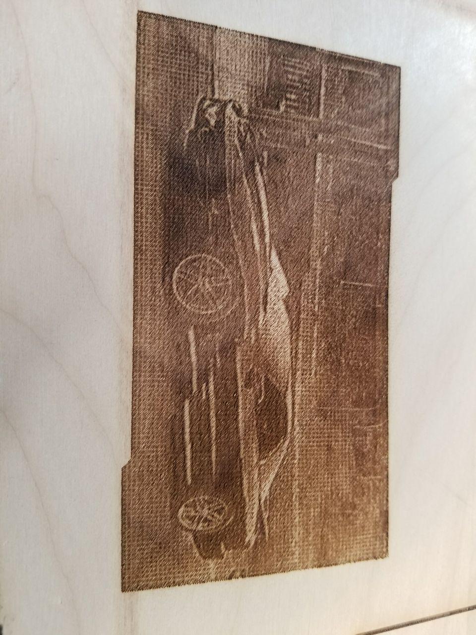

Hello everyone I was doing a test engrave of this picture and it turned out like this. Did I do something wrong or is it maybe a bug? I am using laserweb 4
Something wrong will depend on knowing exactly what you did
It looks like the laser was scanning diagonally and a belt on the X axis (from the camera’s perspective) slipped a tooth.
