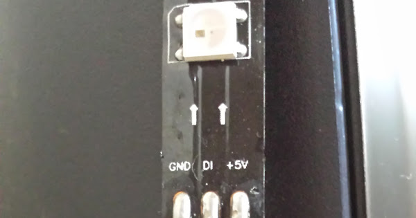

Google Photos
Can anyone help me identify this LED strip and says if its compatible with Arduino UNO R3? I already have one like that, and want to know if I can use that instead of buying a new LED strip. Thanks
If I’m correct, it’s WS2812B. This will work perfectly for a starter project. If you intend to make larger or more complex projects then you could look into other types of LED strip but WS2812B is good for smaller/simpler things. Every type of LED strip should be compatible with any Arduino board which can run FastLED, so you will have no problems with that.

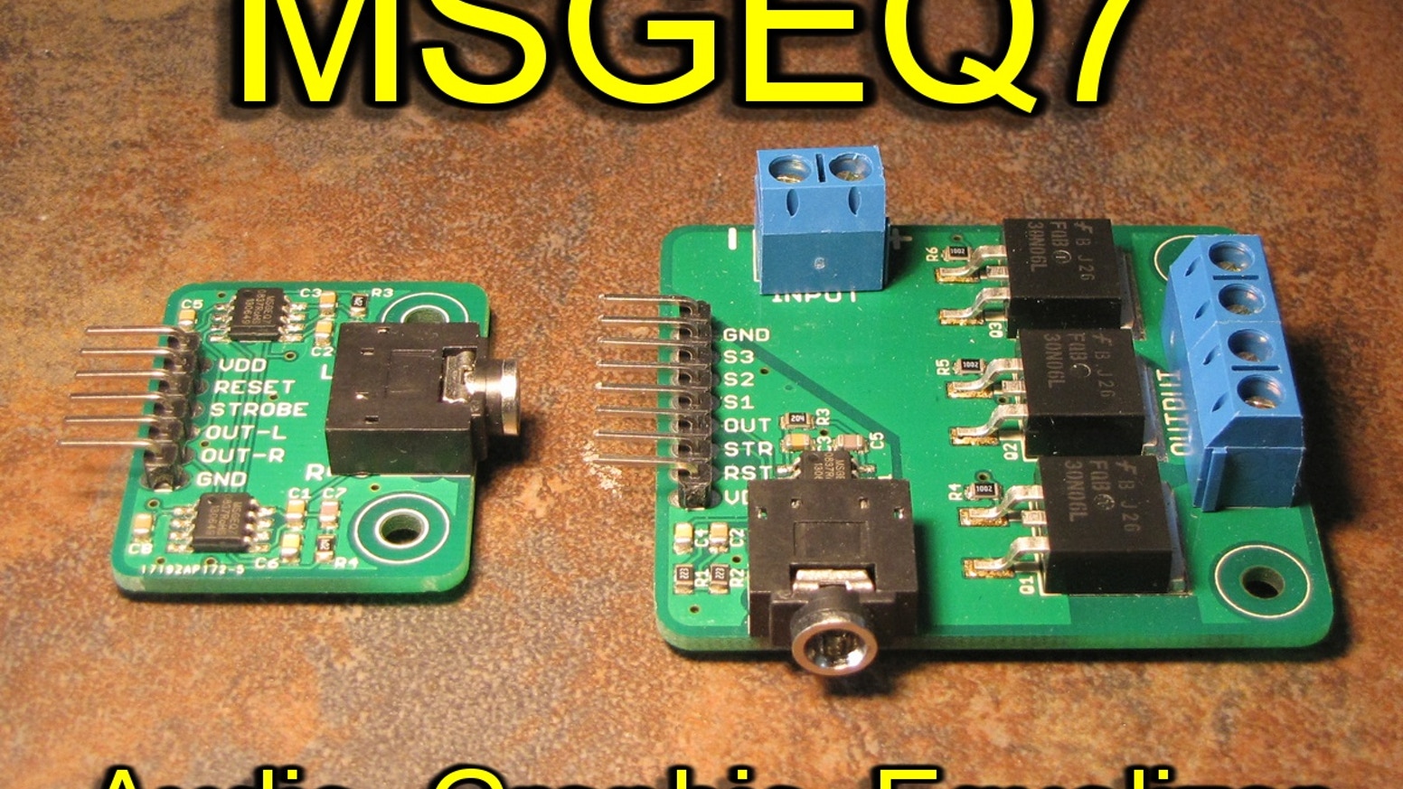

@Anh_Phuong_Tran
I have used the MSGEQ7 IC for the music sync
With Arduino UNO, mega, and Teensy3.1
I can send some info to help you start.
@Hung_Vu Please do, It will be interesting. Thanks in advance.
To use with Arduino ( uno or mega)
To use with teensy 3.1 or 3.2
