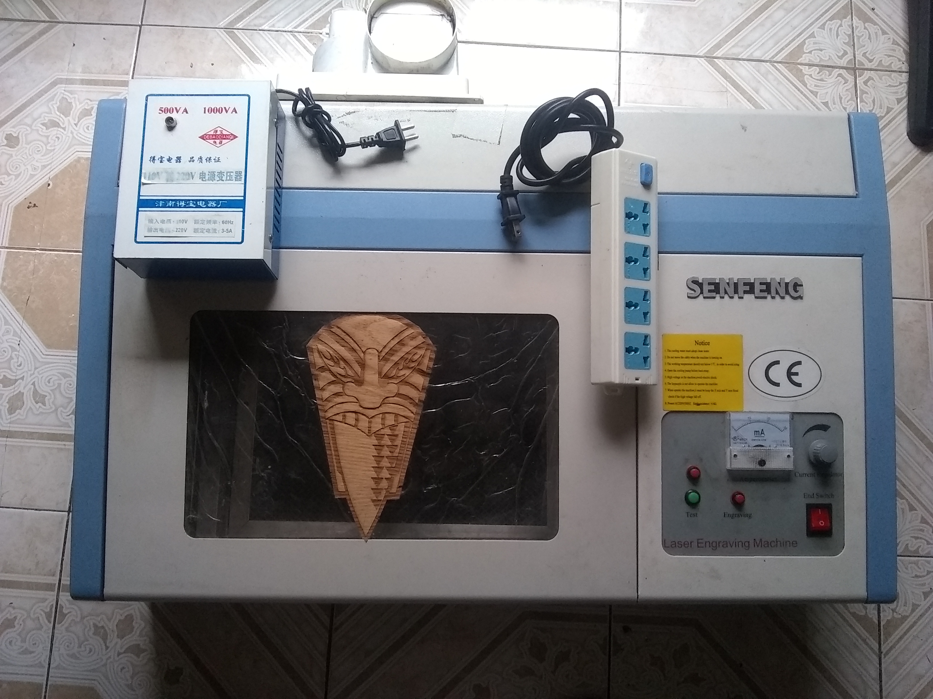

Hello everyone I’m new to laser engraving community. I recently bought a Senfeng laser engraver 220 volt. It can with a 110v to 220v converter The guy that sold it to me said that that’s what it was. It also came with a 250v power strip and no software.
Does anyone know what software works with this machine? How do I connect this to each other? Any information would be appreciated thank you for your time.

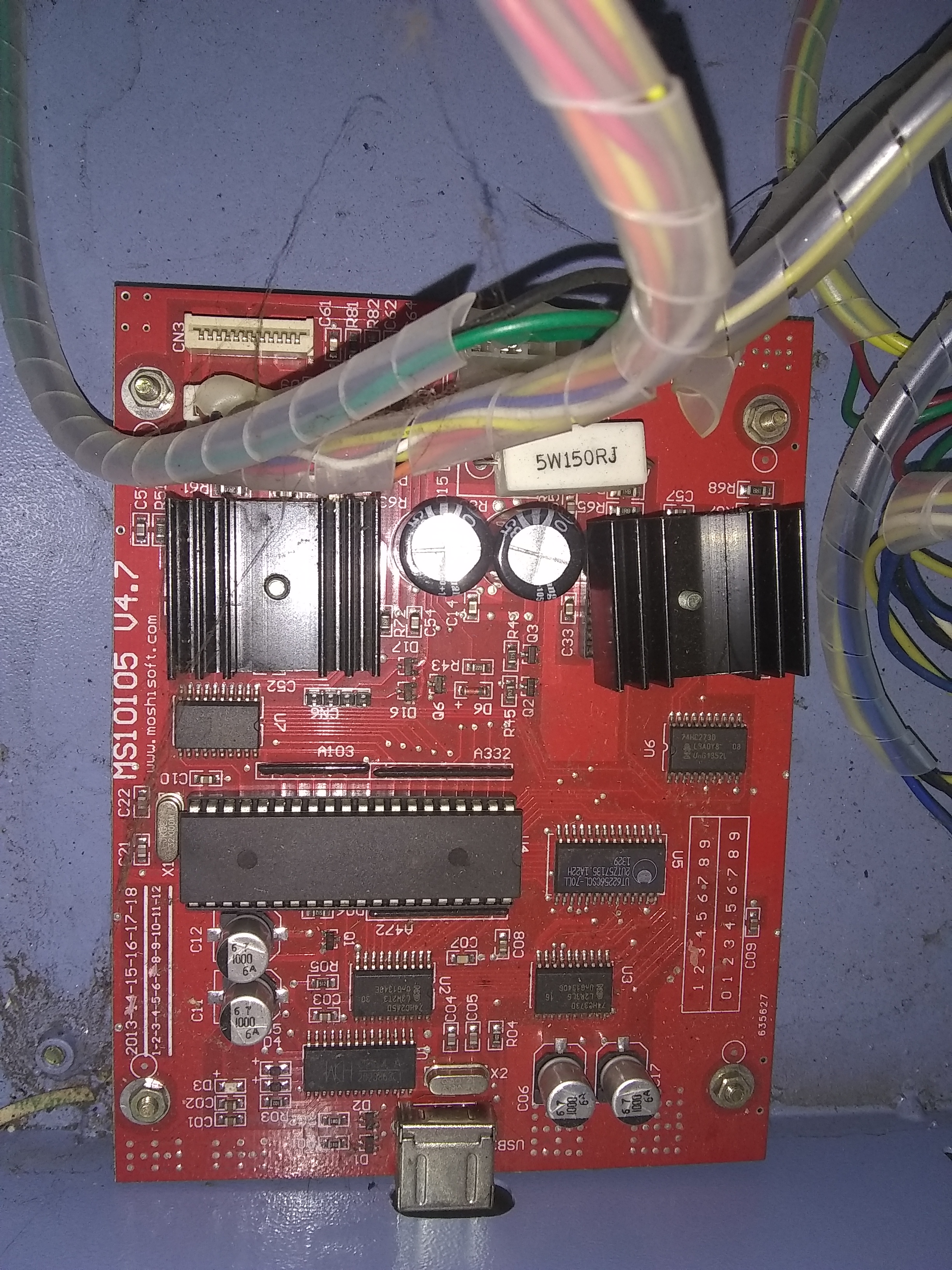

What control board is in it? Post a pic if you do not know.
@HalfNormal
@HalfNormal
Ohh an old school Moshi board. I think LaserDrw may work with it.
Did it come with a USB dongle?
Yep, that is a Moshi board. Search here for Moshi and you will find what you need. As Ned stated you need the USB dongle to use it and the software.
@Nedman only Moshidraw software will work.

The software depends exclusively on the type of Dongle that came in it. The Orange Dongle (even the rarest) gives you access to the latest version of Moshidraw, provided you install the drivers correctly. There is the “Red” version of the dongle that gives access to the Moshidraw 2014.3
Already that’s no big deal. Moshidraw is by far one of the worst software for engraving on this machine, and the 30x20 working area is quite limited.
