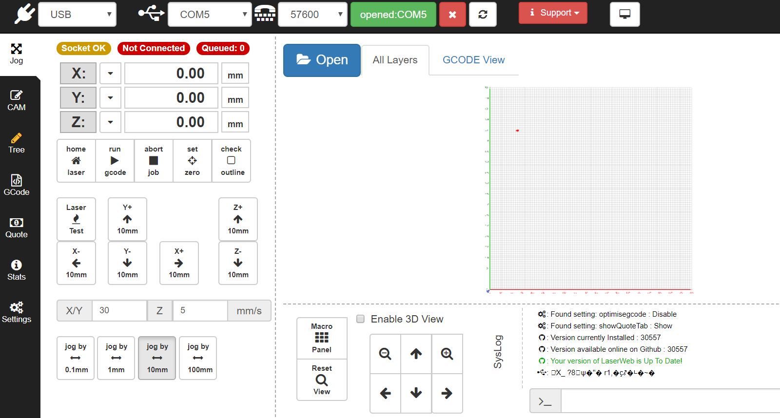

I’m starting in the world of laser engraving. However, I seem to be lacking some software skills to get everything up and running. I have roughly a 1000m2 machine with an Arduino CNC Shield Rev 2.7 and a 2.8w laser. Nonetheless, I couldn’t so far been able to run the machine properly outside of using the shit software it came with. So far, I’ve followed the tutorial by JordsWoodShop to set up the Laser machine with LaserWeb3 which was an initial processing success. However, before I could engrave anything it stopped working and it properly didn’t help to install LaserWeb4 afterwards with the installer, not knowing the requirements it had as the Wiki in GitHub isn’t as detailed as on the Wiki of LaserWeb3. Now my machine doesn’t connect to either program and I don’t know how to uninstall everything and start from scratch or better yet fix the problem all together. Please would someone kindly lend me a hand to solve this problem?

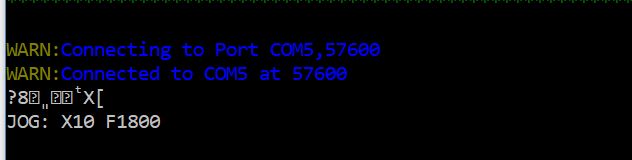

When I connect it and I try to jog it it comes up with this error in LaserWeb3 in LaserWeb4 it doesn’t even bother to connect at all.
