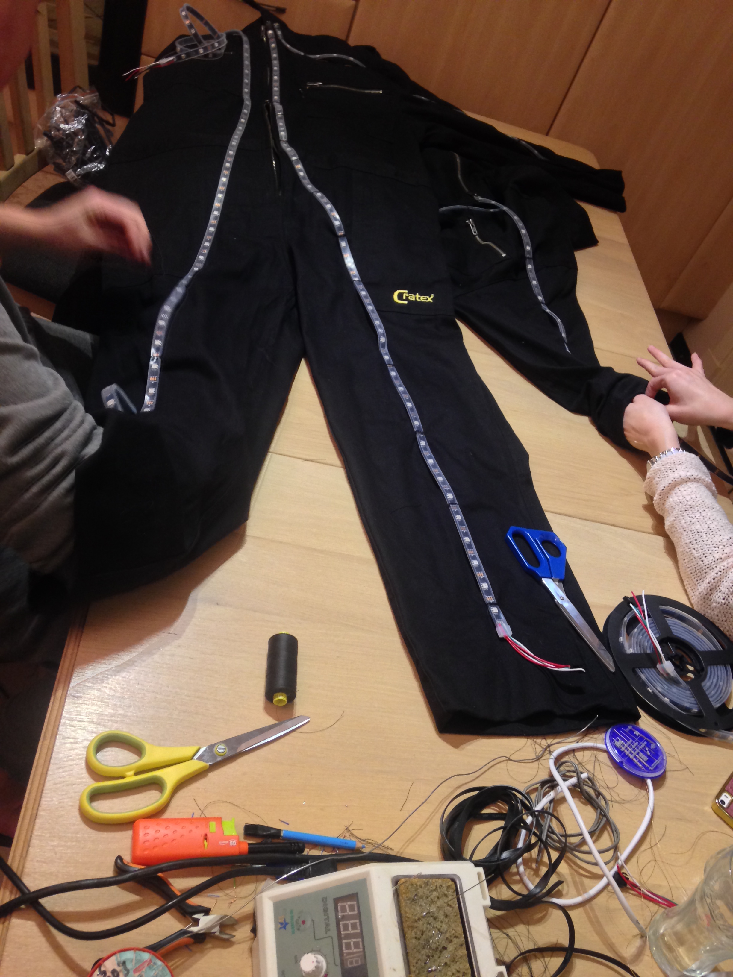

I’m new here and i’m working with a friend of me on a suit for carnival. We have sewn 2 x WS2811 led strip to a suit (left led strip and a right led strip). We have bought 2 USB accu packs and a Arduino nano.

I can’t help you with the sound aspect, but feel like I should give you a heads up about your knees, waist, and elbow. The strips are flexible enough to apply to curved surfaces, but not flexible enough to last under constant bending. If you start bending the elbows/knees/waist a lot, you’ll probably end up with a broken connection. If you have time, you should cut the strips wherever there’s a joint and solder some loops of wire that can flex while the strip remains fixed. All the best on your project!
@allanGEE We have the ip67 version with a silicone tube. We hope it last, but the suit itself is already very wide and we are skiny persons. So there is not an extreme bending in the led strip when we wear the suit. Also there is no pressure on the led strip itself when we move arm/legs.
