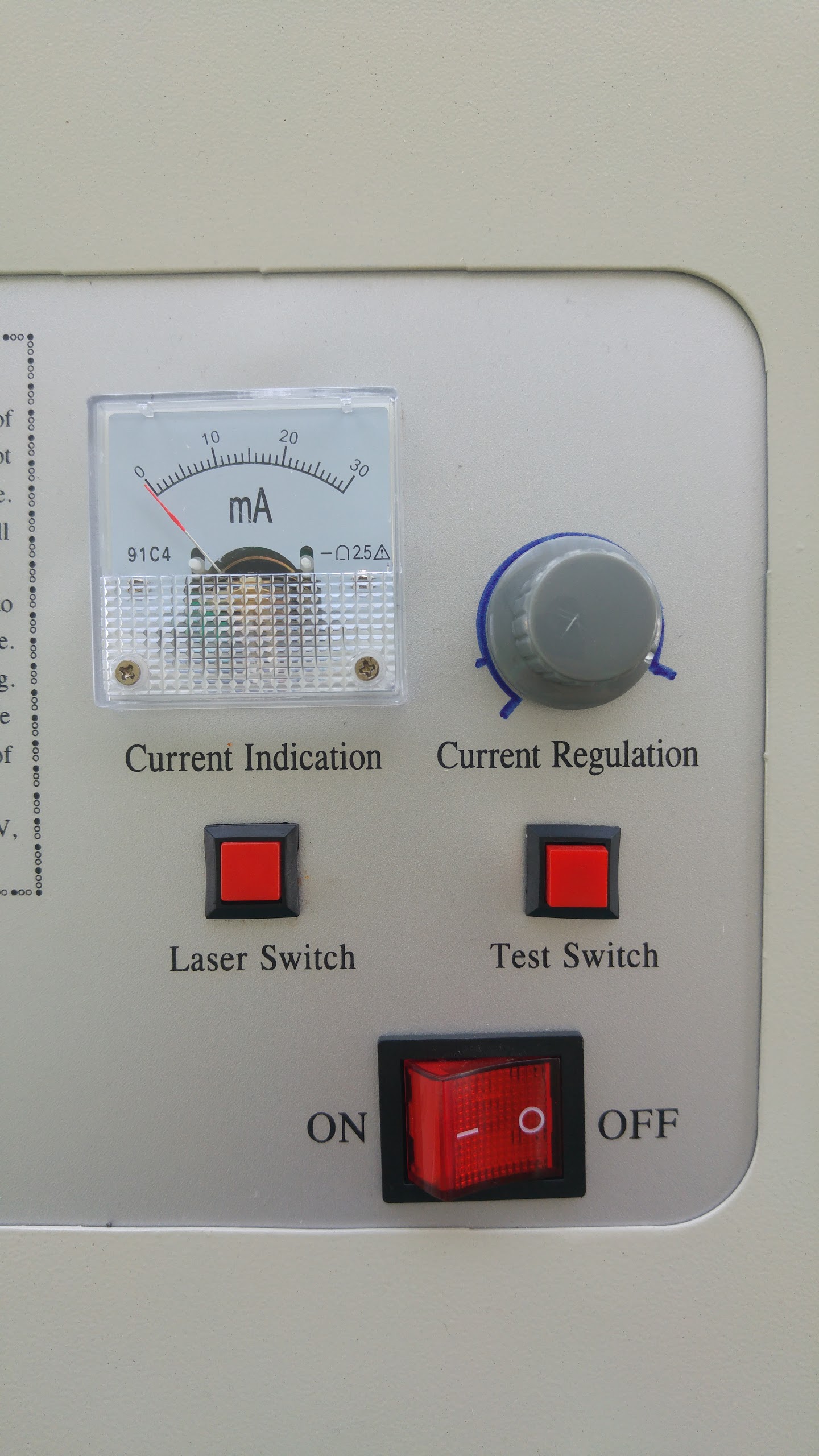

Hello fellow engravers, I have a question about my k40. The thing is that I’m concerned about my cutting power. The current regulator has a travel distance as marked by the blue line, but the laser tube starts working only at the point 2nd from the left and if i give it full current it has the current indicator only goes up to 20mA. Is this behaviour normal, or should I be concerned?
Yes that’s normal.

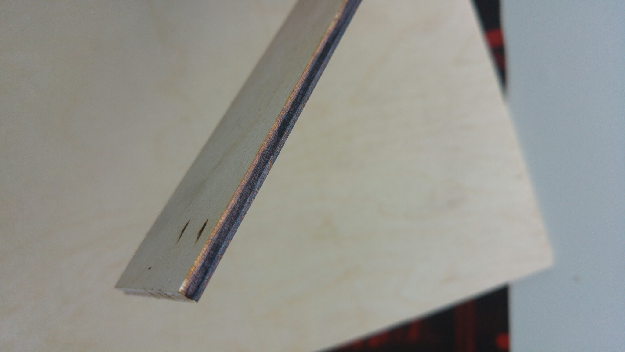

Okay, two more questions. Is it possible to get through 4mm plywood not getting it as black as coal? And the 2nd is how do i choose the number of passes in corellaser, because it started doing 2 for some reason

Different plywoods will show different color characteristics (type of wood, type and amount of glue, thickness, etc.) Some plywood I cut is hardly brown, while other brands are much more black. Also, a powerful air assist will help cut down on the conventional burn/flair-up which can add soot. Try different speeds/power ratios.
