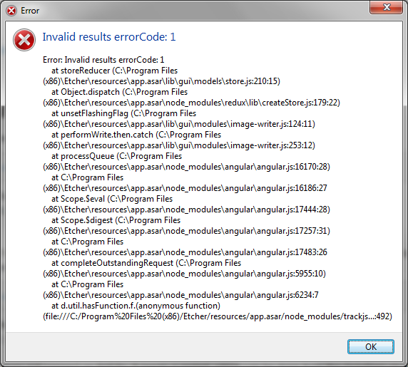

I have just recieved my replicape Rev B3 but i haven’t been able to flash the Kamikaze image correctly to sd. Most of the time the flashing procedure runs trough without a problem. But after the validation i get error messages like this.
Things that i have checked/tried so far:
Etcher is running as admin.
I have tried 4 different sd cards, all have 4GB to 8GB. After every attempth to flash the image the sd card is corrupted and i have to rewrite the disk partition using diskpart.
i have tried flashing the image on two PC’s one running Win 10 and Win 7.
I have tried the “experimantal” an the “normal” kamikaze image.
I am using 7-zip to unpack the image.
I can flash the BeagleBoneBlack_Debian#Flashing_eMMC without a problem and also connect to the BBB afterwards.
Any help would be much apreciated.
Cheers!
Max
Use Win32diskimager. It works fine. I cannot burn image with Etcher too, but it doesn’t want to even start burning process.
I agree with Daniel I cant get etcher to work but win32 works great.
Elias, I think it will be good to put back info about win32 in wiki together with Etcher.
Yep, i’ve tried using win32diskimager to…just forgot to mention it. I can write the image to the sd and flash the Beagle bone. The LED’s do their knight rider thing and light up at the end. I disconnect the usb, eject the sd card and reconnect the usb. The LED’s start to flash and the Beagle bone is recognised as an external device briefly but dissapears again from the list of external devices. I can’t connect over USB or Ethernet cable. And the LED’s are flasching in a recurring pattern.
Weird though, I’ve used Etcher several times without issue… But it may not be the very latest version. I’ve used 1.0.0-beta.10 on Windows 10 Pro and Ubuntu with no issues.

Wait 2-3 minutes after flashing before you turn off the power and remove SD card. Do you have Manga screen?
One more thing. After flashing and waiting some time try to connect with ethernet - it should works. To connect with USB needs some additional BBB configuration after flashing but I haven’t tried it.
Hey Daniel,
I am now able to connect via Ethernet after a few tries. For some reason the connection was getting interrupded after a few minutes. I guess the same thing happend when I tried connecting via Ethernet the first time, wich left me thinking the board wasn’t flashed correctly. After updating the packages over SSH the connection appears stable.
Thank you!
