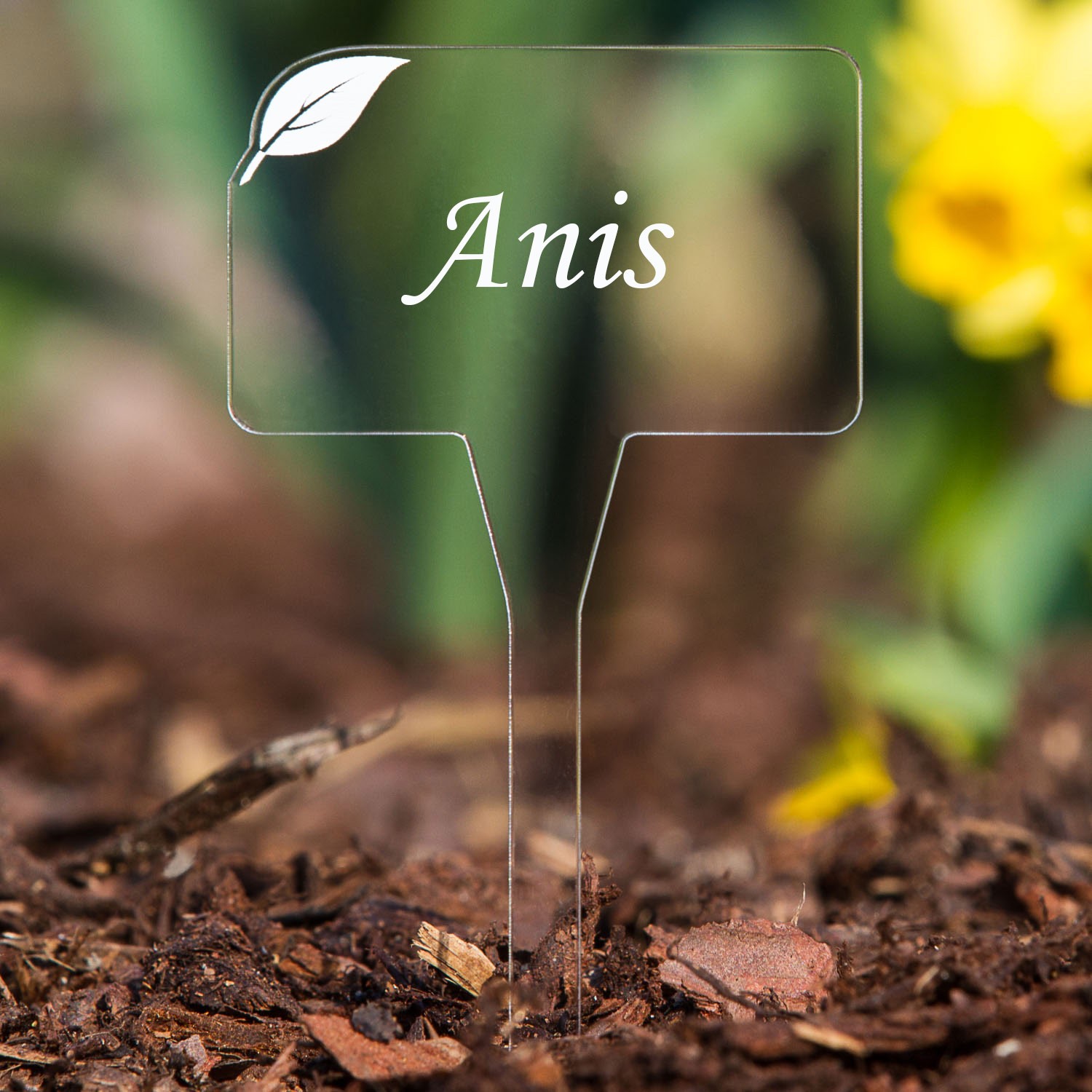

My K40 just arrived and I was wondering if I can make things like these (laser engraved acrylic plant marker, acrylic businesscard).
I’ve tried a lot of settings and have exactly the same material but it doesn’t even get close to that.
