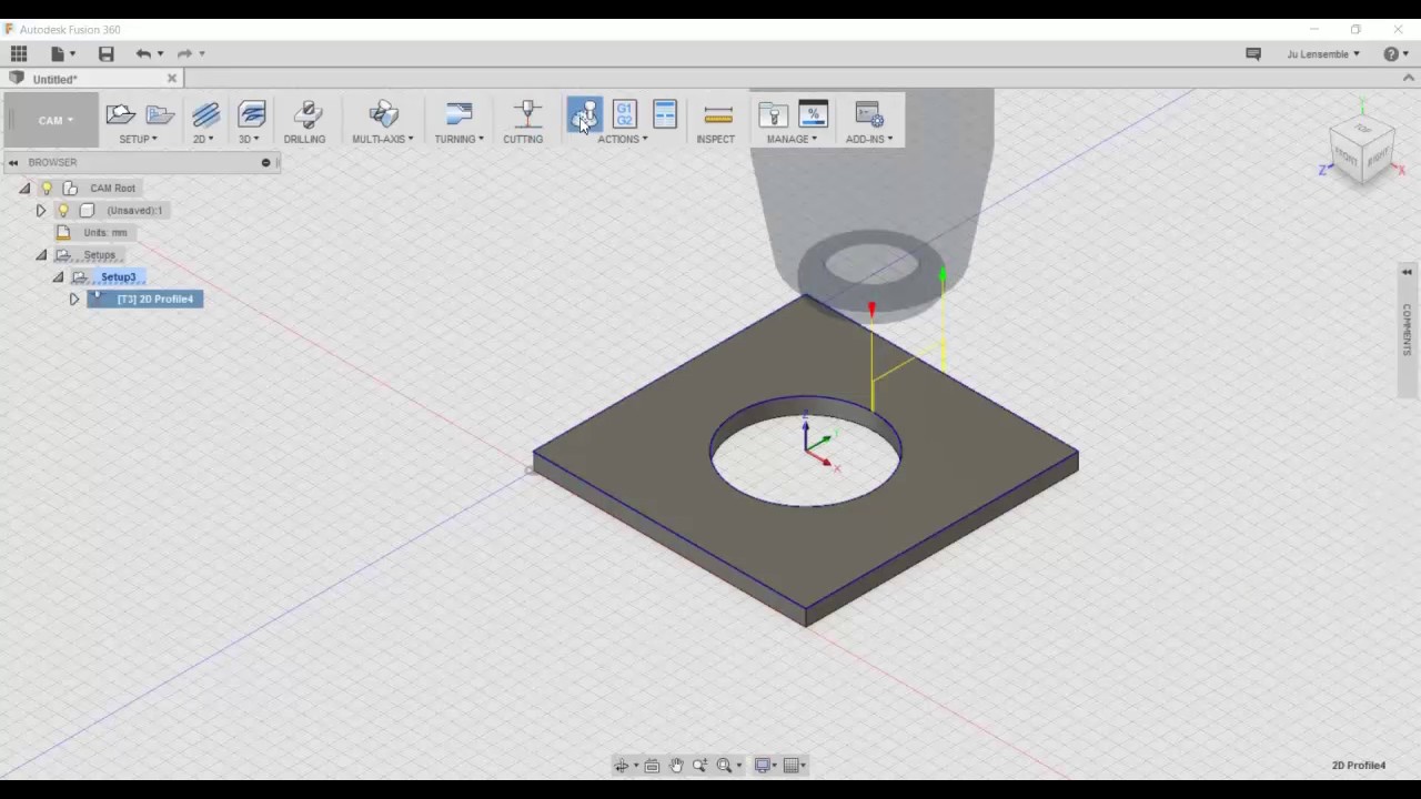

So, my dream is to use the new laser cam in fusion 360 with my grbl. First of all i have to change the new grbl-laser post-processor that he support the PWM Settings in this firmware ($33), cuz i read an article that this settings is very important to cut different materials.
“During the cutting process, the Frequency parameter is decisive and is given in Hz (=Hertz). It specifies the number of laser pulses per second. For a CO2 laser, the value can be set within a range of 1,000 to 60,000 Hz. For example, if you want to achieve a smooth edge when cutting acrylic, you need higher temperatures and thus this value is set to at least 5,000 to 20,000 Hz. On the other hand, when cutting wood a low frequency of 1000 Hz is necessary in order to achieve, for example, the brightest possible cutting edge.”
Here my changed post-processor with this new setting in start gcode. I use a dwell line to make a short break to let grbl save this setting in his eeprom.
Fusion360 grbl-lpc Postprocessor:
(!) Please use the new Laser CAM Feature in Fusion:
(!) Please use compensation type = ‘Computer’ at profile settings for laser.
To use in Fusion is very easy, also exists a UniversalGcodeSender plugin for F360. please check this github and watch the video:
