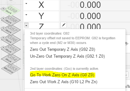

Hello Friends,
please have a look to this merged Pullrequest:
I fixed here the G10 Commands to the correct Offset, please check this:
Change to another WCS: i.e. G59 and use this menu point, after that the Z-Position switch o zero.
Hello Friends,
Thanks for this update Frank. The WCS features keep getting better with everyone’s help.
