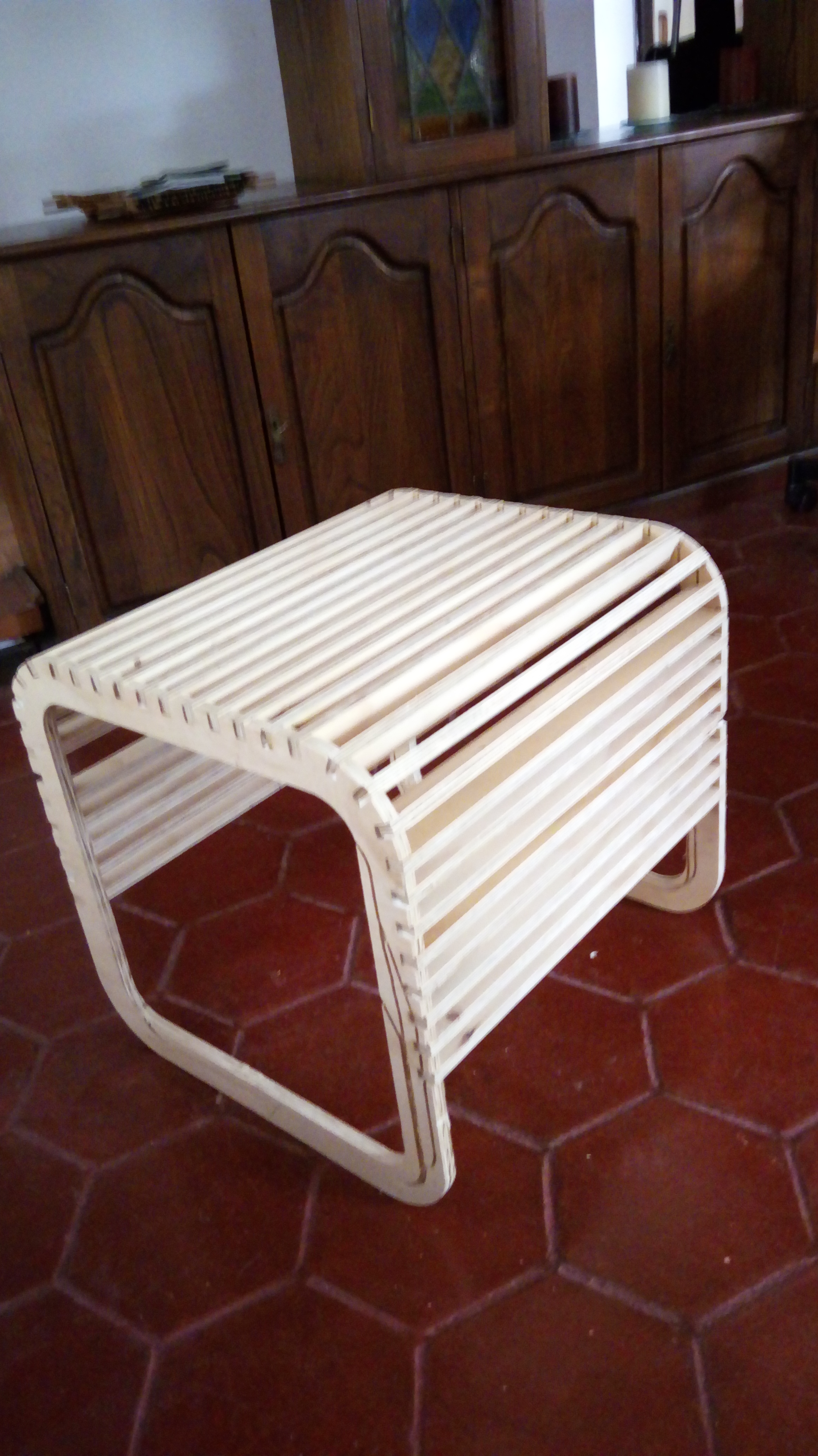

hello friends, this is my first furniture that i make with my smw3d machine, the joints were incredibly tight, just want to ask for your help for the woodworkers, what is your experience with the feed rates for plywood, i use a 1/8 2 flute end mill, with 300 mm/min and a spindle with 10 rpm, each pass the machine was cutting 0.5 mm, the plywood was 12 mm thick. the edge finish was very neat, but it took a long while to do it, i feel the machine can work much faster, but i dont want to explode. Cheers guys

@Felipe_de_la_jara an absolutely beautiful build sir!! You are a true artist!

That is an awesome project. I have been looking for a project to get into cutting some wood joints. I might have to try making something like this. Good job
