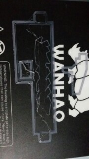

Hello guys, how are you? I have a Wanhao Duplicator i3 printer. I am very happy with this 3d printer, I my first and I am learning about this wonderfull world of 3d. I have a problem with the first layer. as you can see in the photo, the first layer is not being very good. What do you recommend to me for fix this problem? Thanks for your answer and sorry my bad English. Have a good day.

Its hard to tell from the oic but it looks like your nozzle may be to close to the print bed
