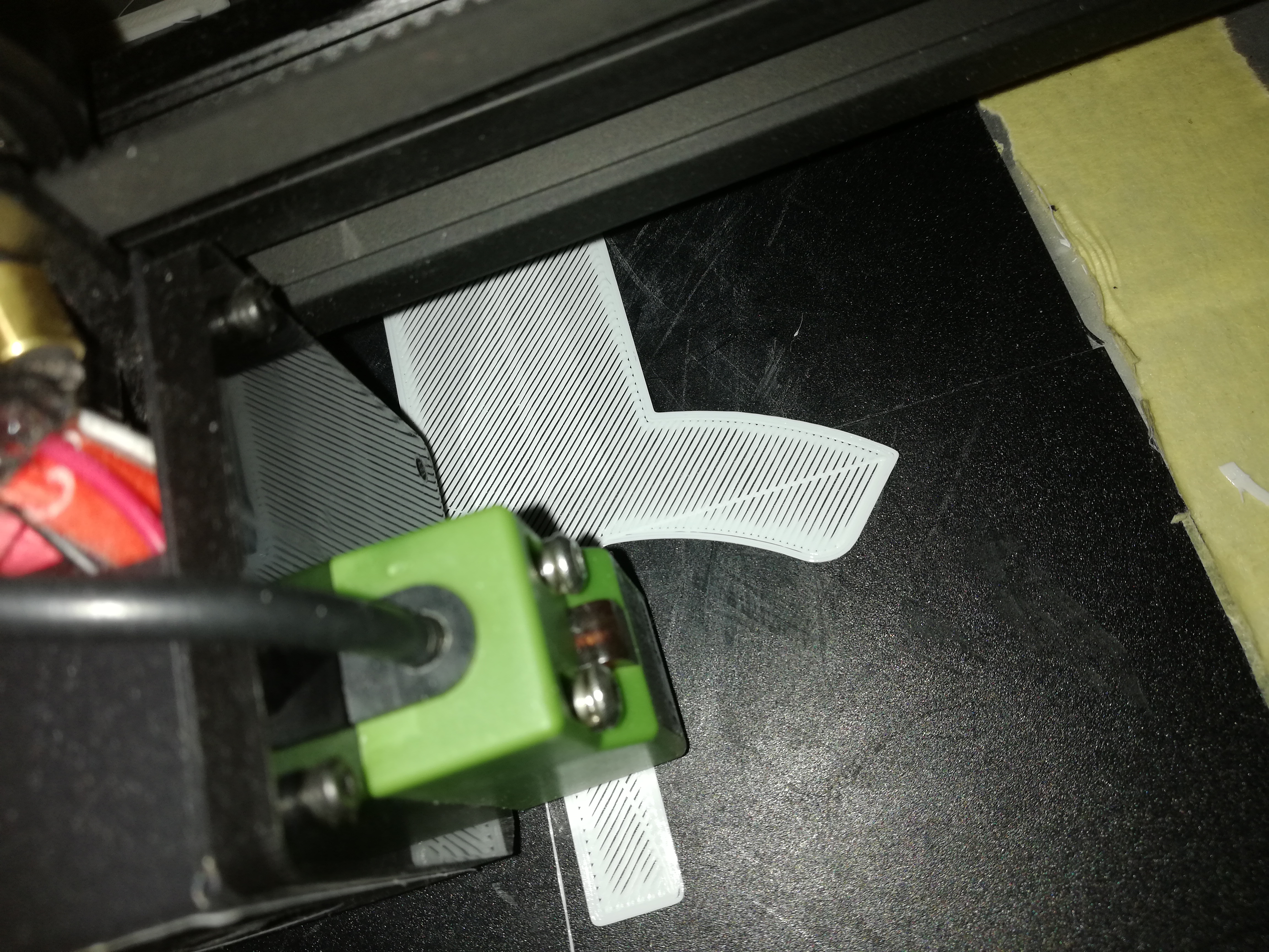

Hello guys i am having problems asume on under-extrusion?
Hello guys i am having problems asume on under-extrusion? I am afraid that have to correct steps and maybe i also found that motors are getting quite hot(setting up drivers) . Any ideas or is different problem? Printer: Ender-4
Appears to be under extrusion, what printer?
Here’s a guide for calibrating the E steps: https://www.youtube.com/watch?v=YUPfBJz3I6Y
Might want to check your filament diameter too. A few hundredths of a millimeter can make quite a difference. Won’t help your stepper temps though.
