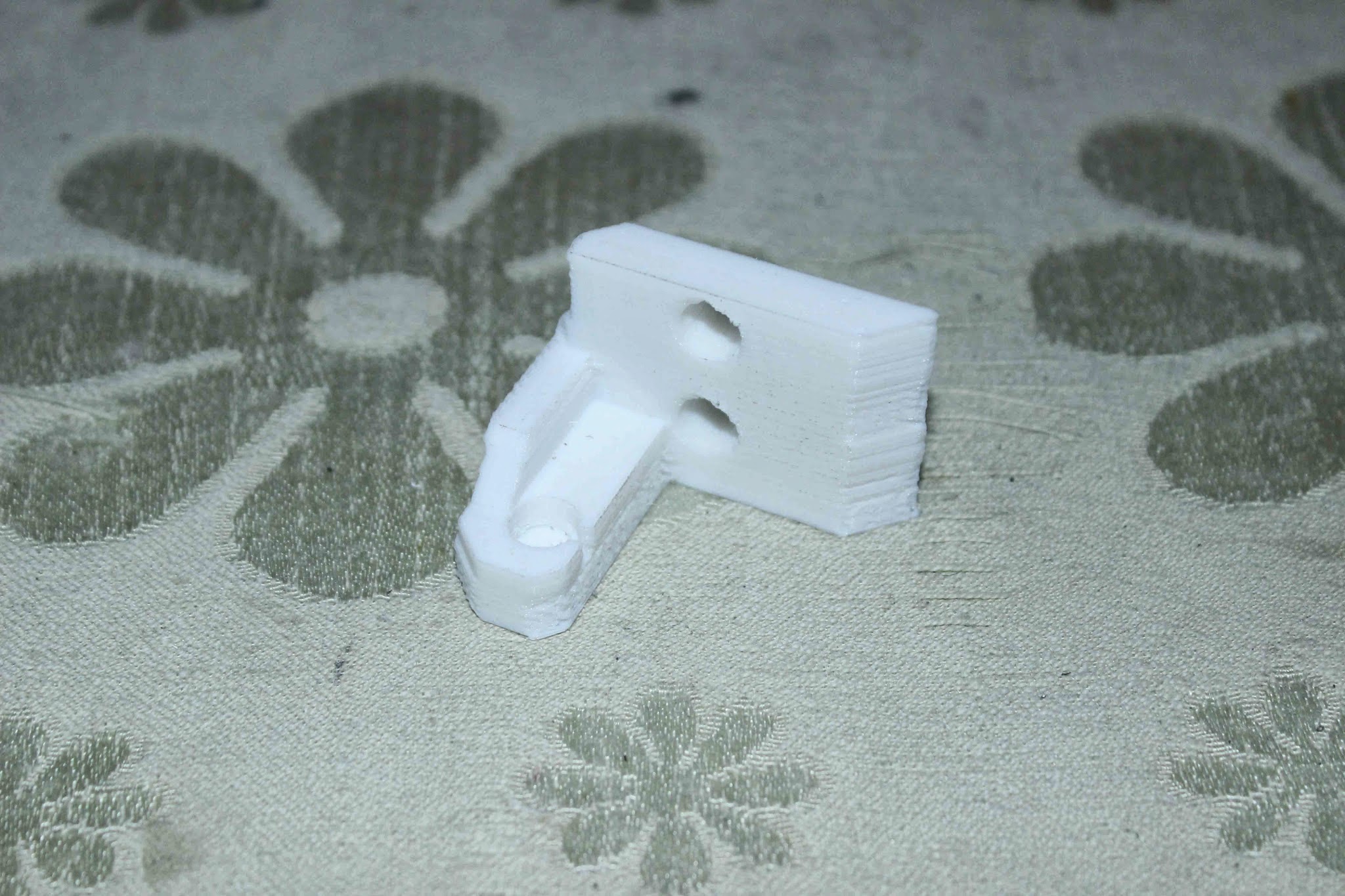

Hello guys. I am new to 3d printing. @D_Rob suggested this community to me. I have been having troubloes with extrusion with my 3d printer after 10-15min of printing the extrusion stops and extrudes then extrudes then stops like so please help i can print anything

I would check the tension on your belt(x,y) , I think I can see a little slack in one of the pics. But for sure need to clean the bobbed bolt of all that ground in filament, which looks as if you need to ease off the pressure on your feed mechanism.

Thanks for all your help guys i think i have solved the extrusion problem it was the tension in the extruder idler . But after fixing that a new problem arised will post new with photos.@boog_nish
