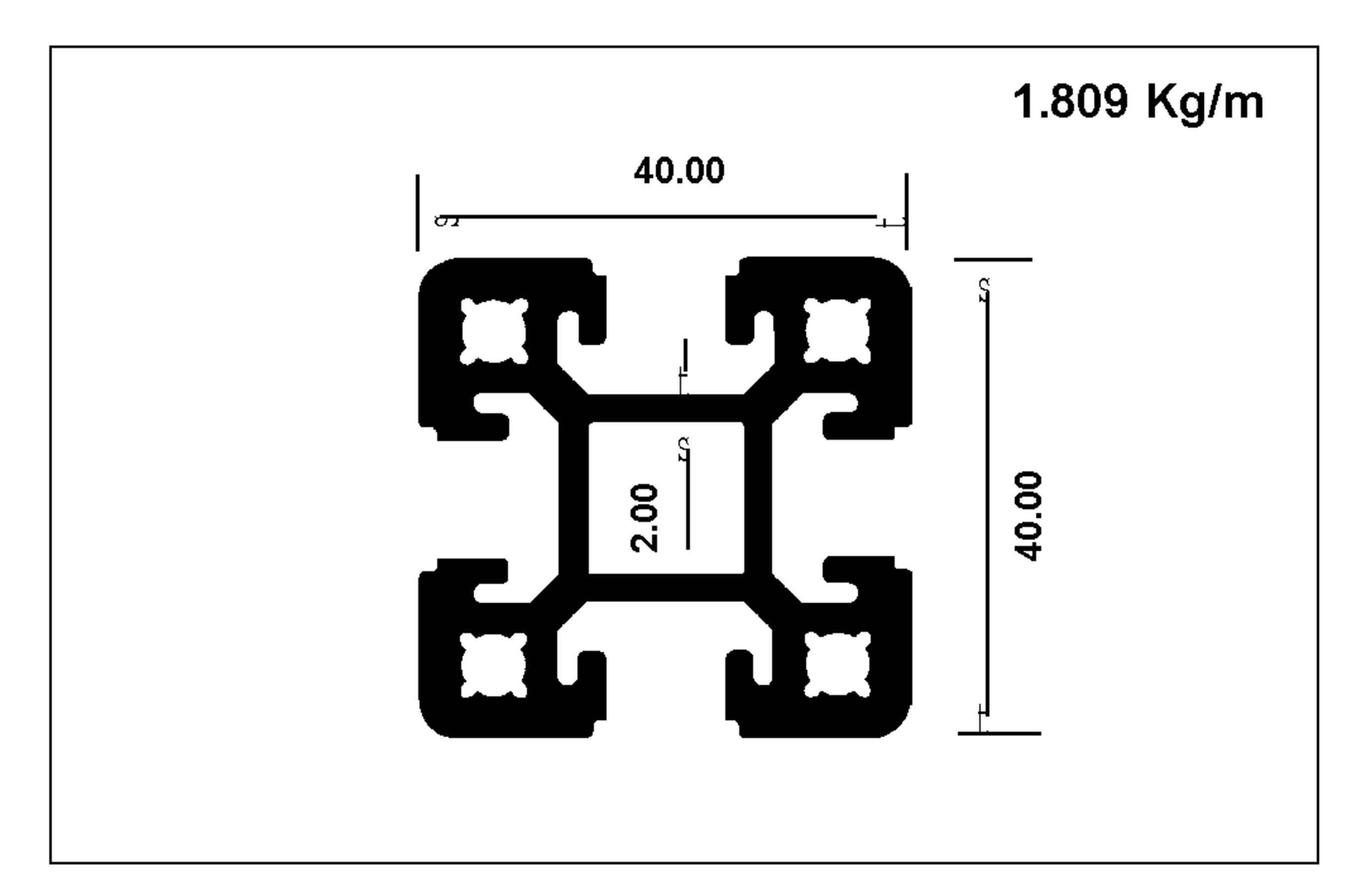

Hello Guys i am thinking of making an Eustahios printer i have aluminum extrusion of below given specs would it be strong if i make cornor joints with laser cut acrylic instead of printed parts
It prolly would be. However the Eustahios has quite a bit of mass. So I am not sure. I would get the corner aluminum connectors and put them in place where possible. I too like the idea of laser cut bearing mounts much better. @Jason_Smith makes it look easy to align the rods, however I did not do as well with my plotter bot design.

@Bijil_Baji , I think most folks using the aluminum extrusion for these frames have gone away from any printed or laser cut parts for the corners. Someone (I think @Tim_Rastall maybe, can’t find it right now) made a video showing how the extrusion can be fastened at the corners by tapping the ends of the intersecting pieces and sliding the head of the bolt into the channel of the perpendicular extrusion. Between this method and the commonly available 90 degree brackets, that should be all you need.
@Jason_Smith ok it would be great if i could see how to assemble the problem with extrusion i have is that it has a large square hole in the middle so mounting screw would be difficult
@Bijil_Baji I see now. you could print an insert thread it and epoxy the insert into the square hole. or if you have a piece to test it on you could see if you could run a tap into it and get enough threat on the 4 points to be suffifient. But why such large extrusion 40x40 is twice what most use. I have a machine with sae 1010 and it is too big 1"x1" I now use 2020
Unless you are looking to make a huge machine, 4040 would be, a waste. A hundred bucks will get you enough 2020 for a 300x300 build volume.
