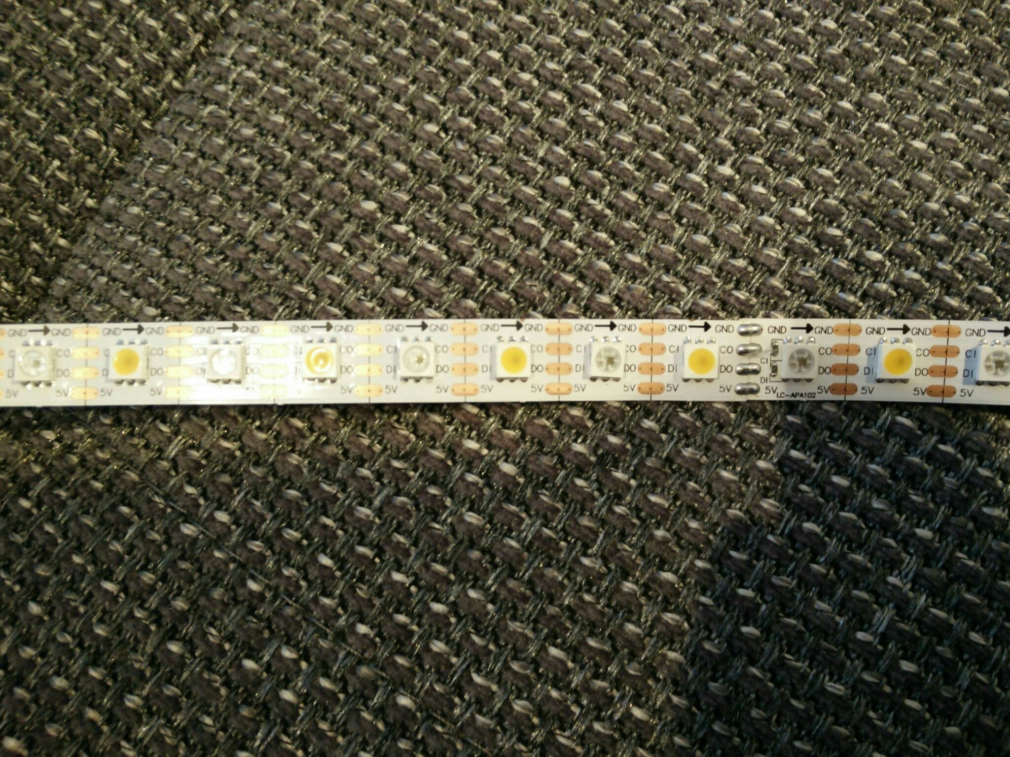

Hello here is a picture of my rgbw apa 102 led stripe.
Hello here is a picture of my rgbw apa 102 led stripe. Any suggestions how I can efficiently control the rgb with the example programs and the white separately? Thanks
Looks like alternating pixels are RGB and WWW?
I don’t have one of these to test, but you could help a great deal in learning about it.
If you take any example program, and add this JUST before the call to FastLED.show(), I bet you can program either the RGB or WWW. Could you try that and confirm?
#define ODD 1
#define EVEN 0
// choose odd or even here
#define WHICH ODD
// zero out alternating leds
for( int j=WHICH; j<NUM_LEDS; j += 2) {
leds[j] = 0;
//now call FastLED.show();
And try with WHICH as EVEN and with WHICH as ODD. If my guess is correct, one way will just light the RGB pixels and one way will just light the WWW pixels.
If that’s correct, then we can talk about how best to program them!

@Mark_Kriegsman your example code works. The white LEDs are WWW! And the whites are ODD. Thanks.
