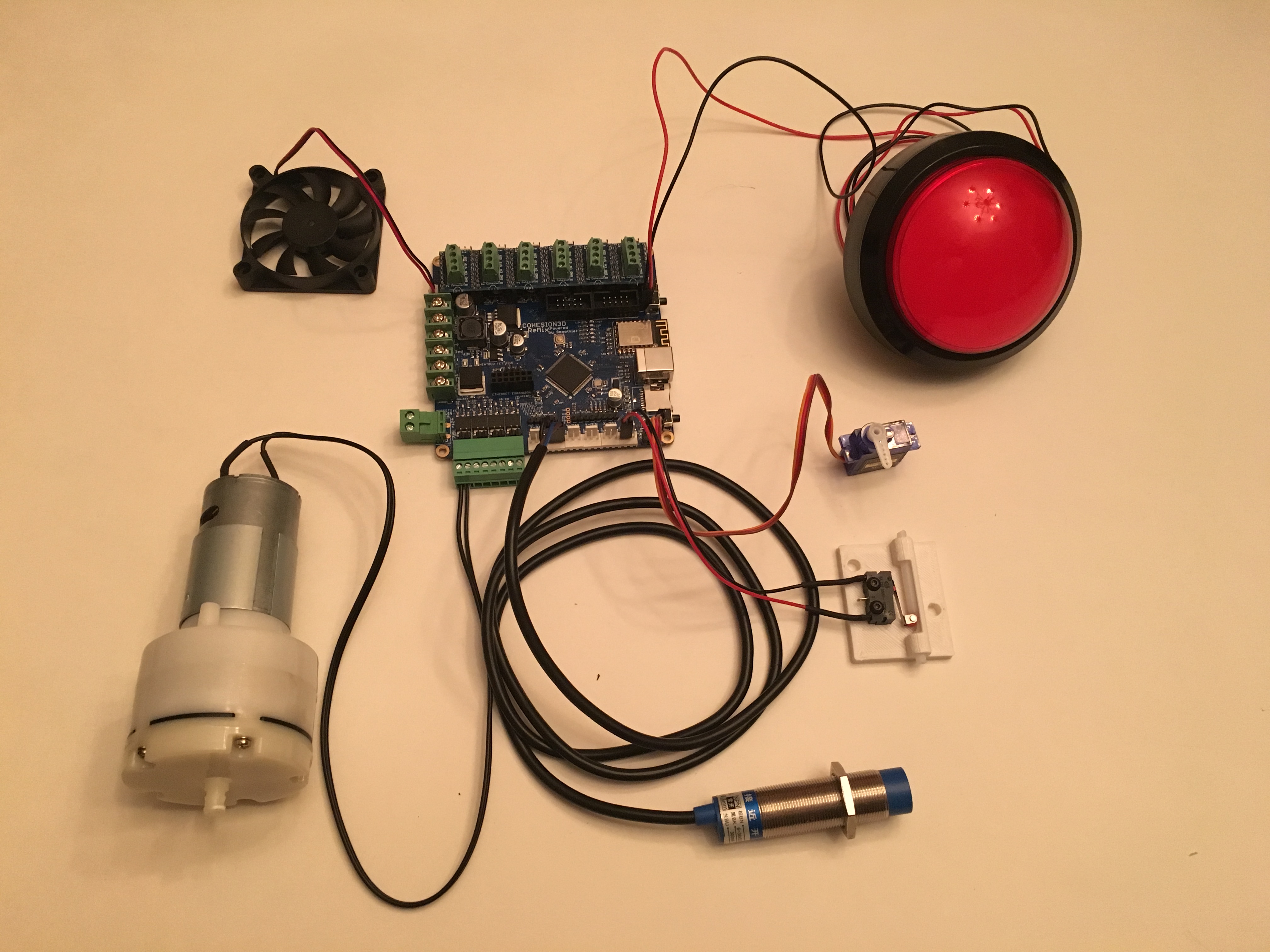

Typically you’ll use external drivers to run steppers at 48v. Here’s a pic of my board the Cohesion3D ReMix demonstrating some of the capabilities for a CNC application, including Signal Breakouts to send the STEP DIR EN GND to the external drivers, buffered endstops allowing you to use inductive sensors at 12/24v directly, a header for external kill button, and flyback diodes allowing you to run a wide range of peripherals including pumps and valves (for dispensing lubricant or clearing chips).
The factory is finishing up the first 100 unit run right now and I hope to have them available and for sale next week, if you’re interested.
Hope this helps,
Ray

No worries, just demonstrating that we’re equipped to drive quite a few different peripherals that people may need.
