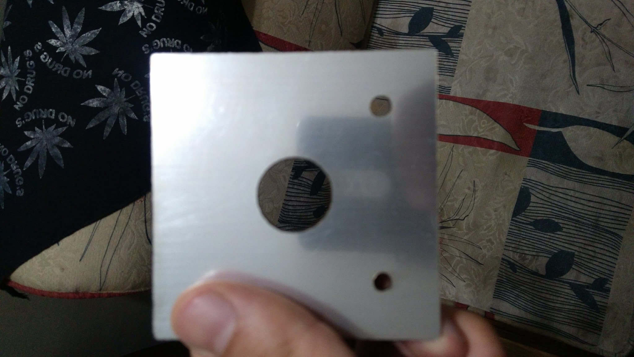

Hello … I already Buyed laser module 2.5w with ttl and including drive but my laser so weak im trying to cut plastic about 2m … i tryed to cut it by 10 passe with 250 cut rate … how i can resolve this problem or how can i upgrade my laser to about 15w or 10w … or where the way to buy laser about 15w thanks
What plastic is this? Are you changing the focus while cutting? Some acrylic colors cannot be cut by blue diode laser
@P_Mido please read carefully my questions
@Ariel_Yahni_UniKpty i dont know name of plastic and i didnt change foucs while im cuting … My laser i measure the voltge while he cut … it measure only 2 Voltage why that … maybe that is the problem
@P_Mido changing the focus while cutting its very important specially on a diode laser, that would make cutting in less passes
@Ariel_Yahni_UniKpty But i be4 i start cutting i change focus to smallest diode … that what u talking about !!
@P_Mido no. With each pass you should refocus the laser. That’s done with Z axis moving down on each pass. If not the your leader is weak at the deeper the cut
@Ariel_Yahni_UniKpty I dont have z axis … bytheway My laser power i measure it i get 2 V … its right or something wrong ?! or maybe that must be over 2 V … and Laser 2.5w can cut how many Mili can cut … im beginner in this kind of this project …
@P_Mido if you need to cut many project diode is not the laser you want. Diode is more for engraving.
You need to check for amp not V. My laser driver proeuces max 2.5amp
