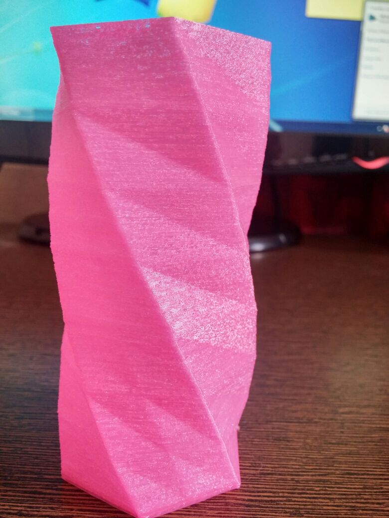

Hello, I am building a Core XY 300*300*300.
Hello, I am building a Core XY 300300300. I’m currently using Duet 0.6 electronics and an E3d original hot end with IGUS linear rails.
Auto PID TUNING is done and still im getting these problems.
Filament: ESUN Magenta PLA+
Temperature: 220 DEG with external fan cooling.
The same filament is working very fine with other printer.
Could it be overextrusion or too much heat? Try 205c
Your actual temperature is off and you are printing too slow. This effect is the combination of slow speed and too high a temperature
@Brook_Drumm Oh yeah, it worked! Thank u so much. I reduced the temp mid print and the result is quite good.
@ekaggrat_singh_kalsi ya, thank u so much for ur information. It worked after I decreased the temp from 220 to 205.
