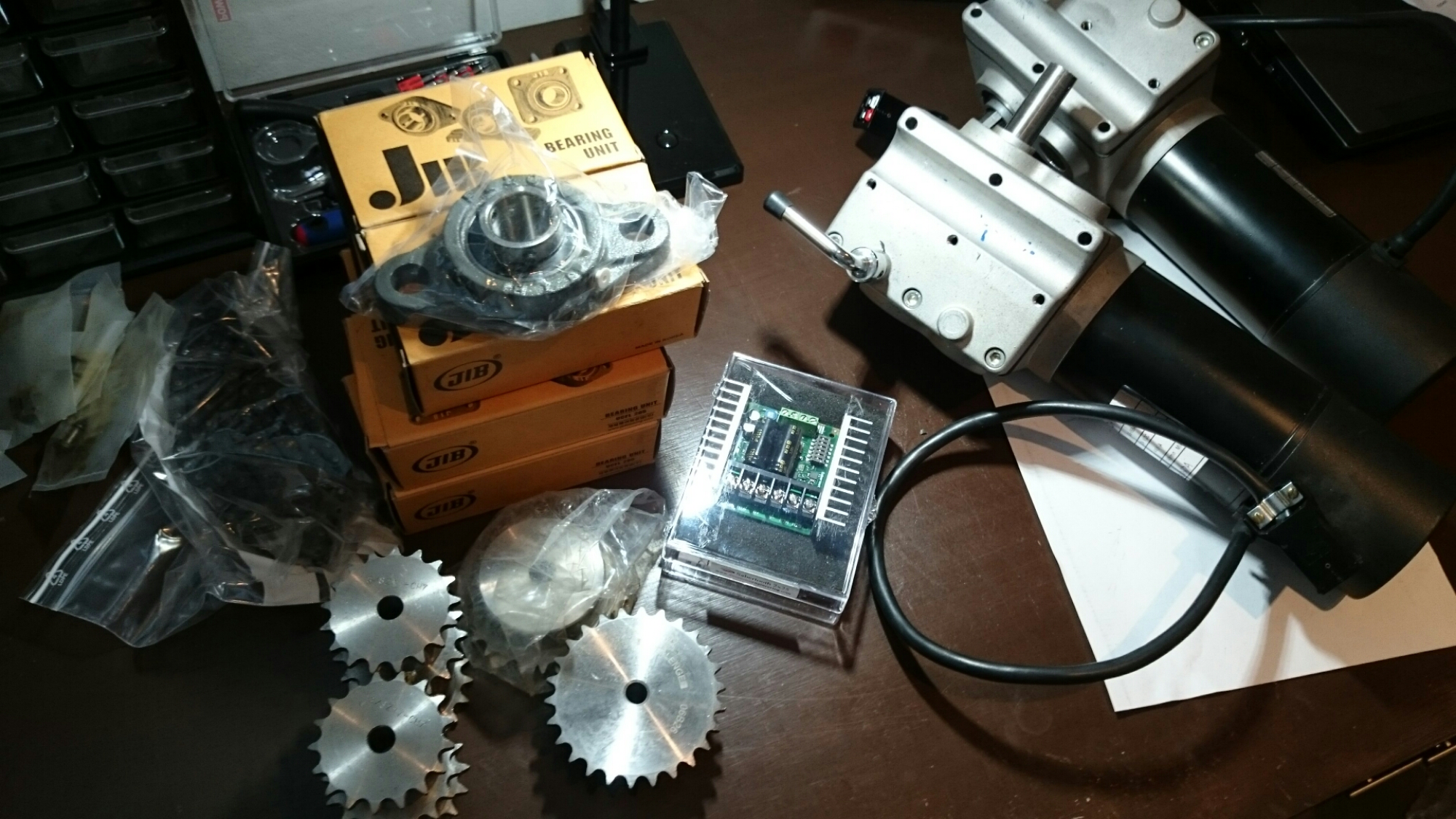

It runs on 24 V and it has two wheel chair motors. It has a Sabertooth ESC in tank mode. (Tracks can be added later on the wheels).
I have got most of the parts waiting for the frame and installation, but before I can send the drawings to metal workshop I need to solve the tool attachment issue.
I was going to use an linear actuator to lift the front “forks” but I want it to be able to lift 90 kg attachments such as lawn mover or snow blower and the stroke of the actuator would be limited so that makes the needed force an issue. Now I have decided to solve that by replacing the actuator with a electric winch. It can handle 900 kg so it will get the attachment up
The base machine itself will weight around 100 - 120 kg.
