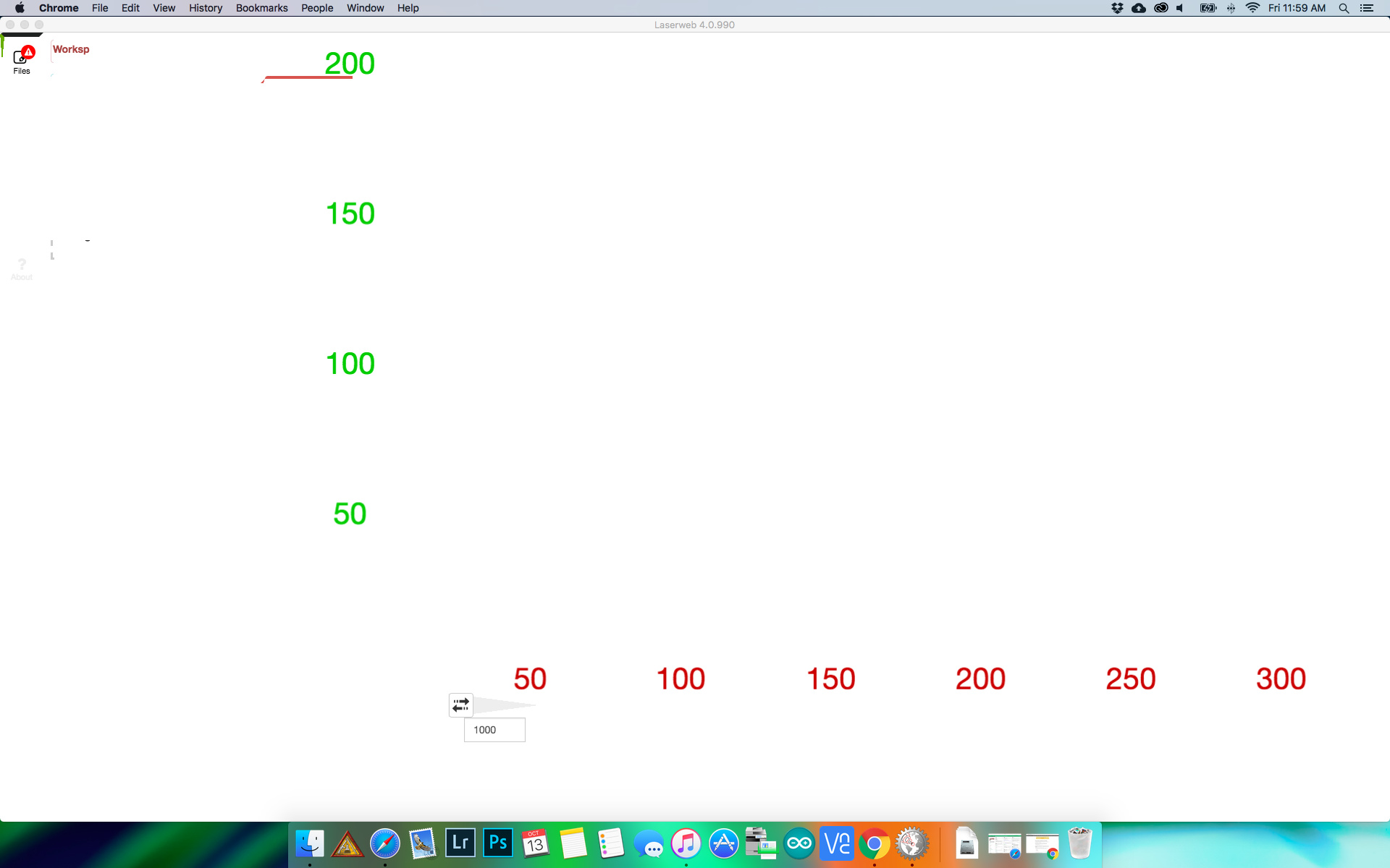

The problem I’m having is that laserweb4 isn’t displaying properly. I have no left-side menus and no grid. The only thing I can see are the colored red and green axis numbers. I’ve gone in to chrome:/flags/ and ensured webgl is active and restarted chrome with no success.

Here is a screen shot of what I’m getting. Any helpful suggestions are greatly appreciated…
You will need to right click on the display and click Inspect to open the Debugger then click on the Console tab. This will give you a better indication of whats going on since it should show an error message of some kind.
Most likely though is that you’re running latest chrome and they’ve removed support for your chipset. Try downloading an older version of Chromium, say version 60, that should still work and Chromium does not auto update so you should have a standalone version of it for use with Laserweb.
