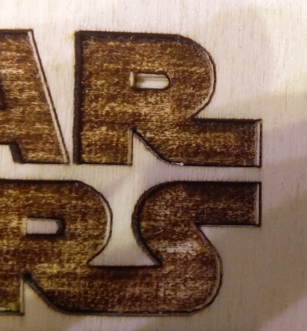

Hello, I am running into issues with engraving and marking with my K40 and a smoothieboard with in Visicut:
- engrave with about 150mm/s.
- mark with a speed of about 105mm/s.
In the picture, you can see that on right hand side of the letters, the marking cuts into the wood, but ideally it should be exactly on the border between burnt area and wood.On the left hand side, the mark is inside the burnt area. So either the mark is too far right, or the engraving is too far left.
On smaller objects, the mark sits perfectly, but for this part, it is skewed. I already lowered the mark and engrave speed, before the effect was a bit worse.
Acceleration is set to 2000mm/s^2.
Because I am already at pretty low acceleration and movement values, I suppose that there is an underlying problem that needs to be fixed. Where are the places to look first?
