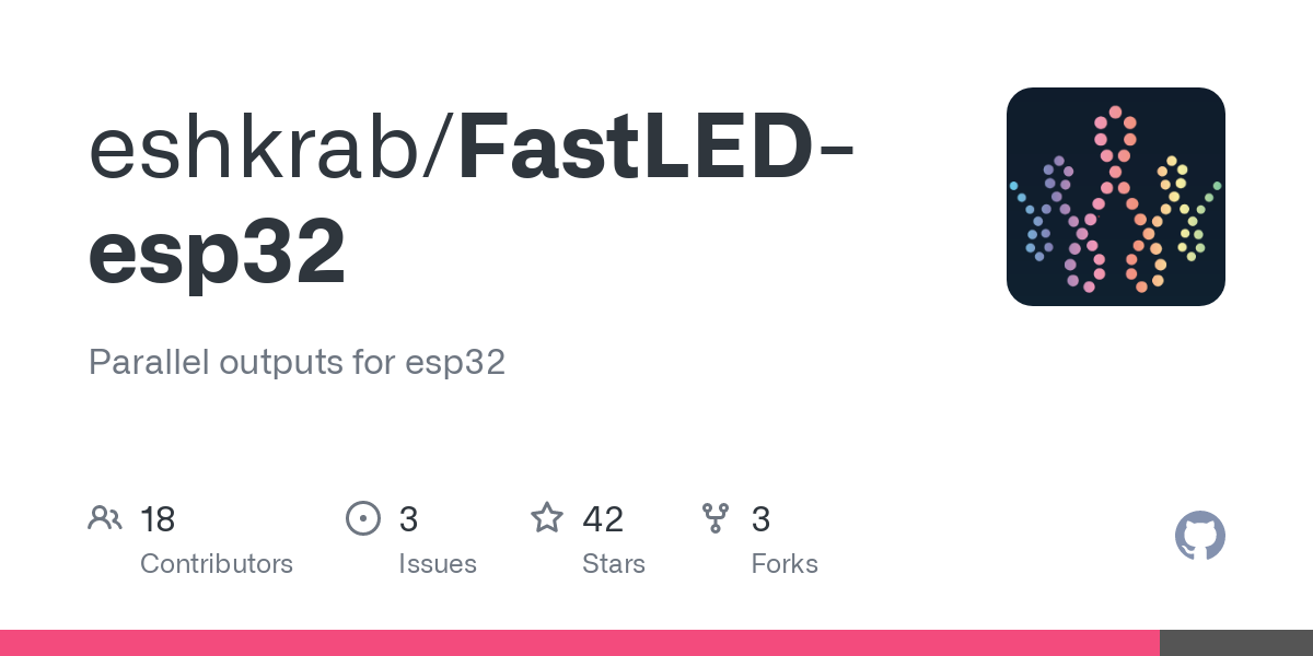

@Jeremy_Spencer @chad_steinglass on the fastLED1.8 I can see that it’s made fro 4 pins 12,13,14,15 if you use the one of GitHub - eshkrab/FastLED-esp32: Parallel outputs for esp32. you can have up to 8 pins 12,13,14,15,16,17,18,19
actually they are the same just the extension has been made In the clockless_block_esp32.h
to handle more pins.
I have managed to get 12 pins working adding 0,2,4,5 to the ones above.
i am working on the 16 pins version
and also on a version where you could choose on which pins you are running the parallel output.
