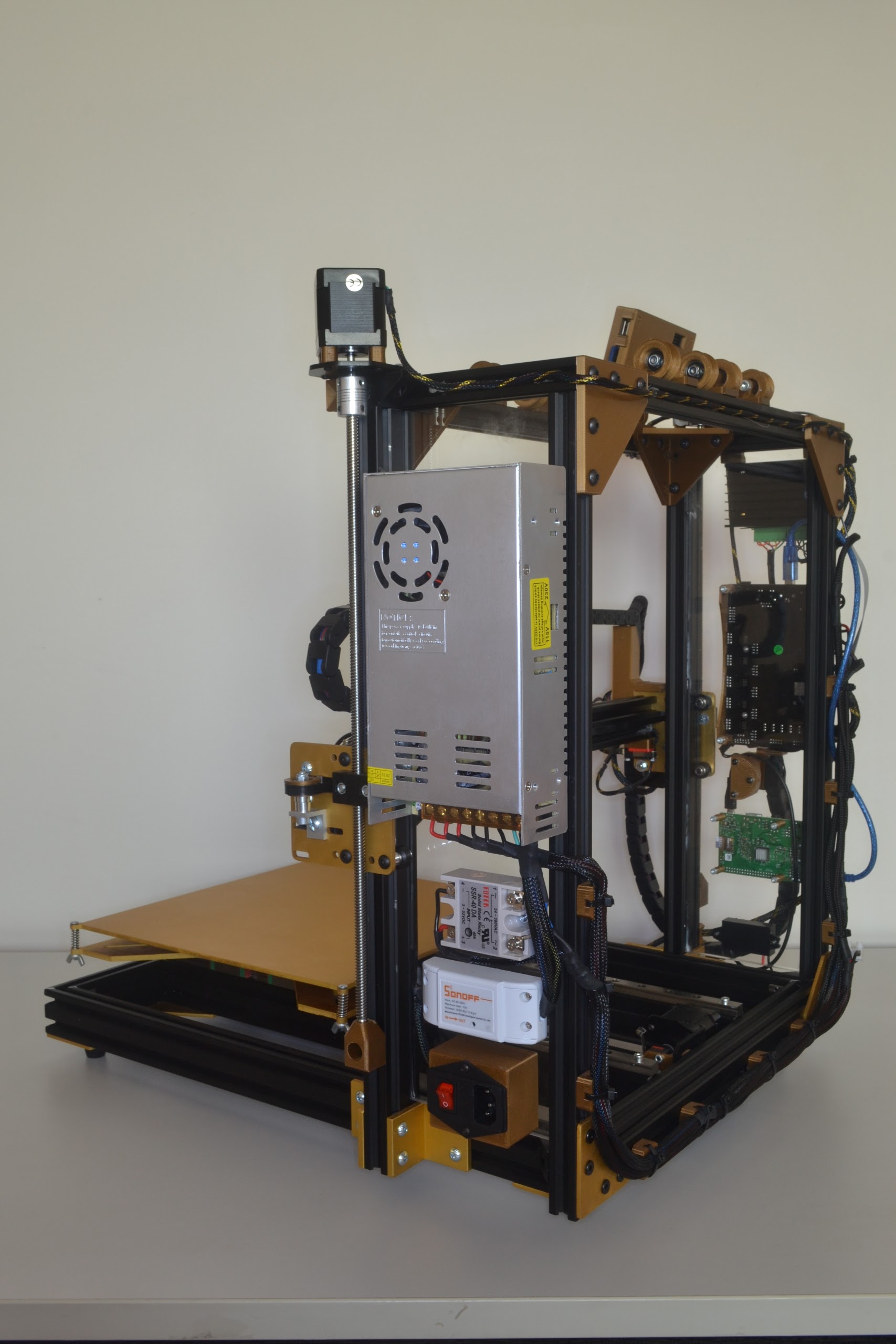

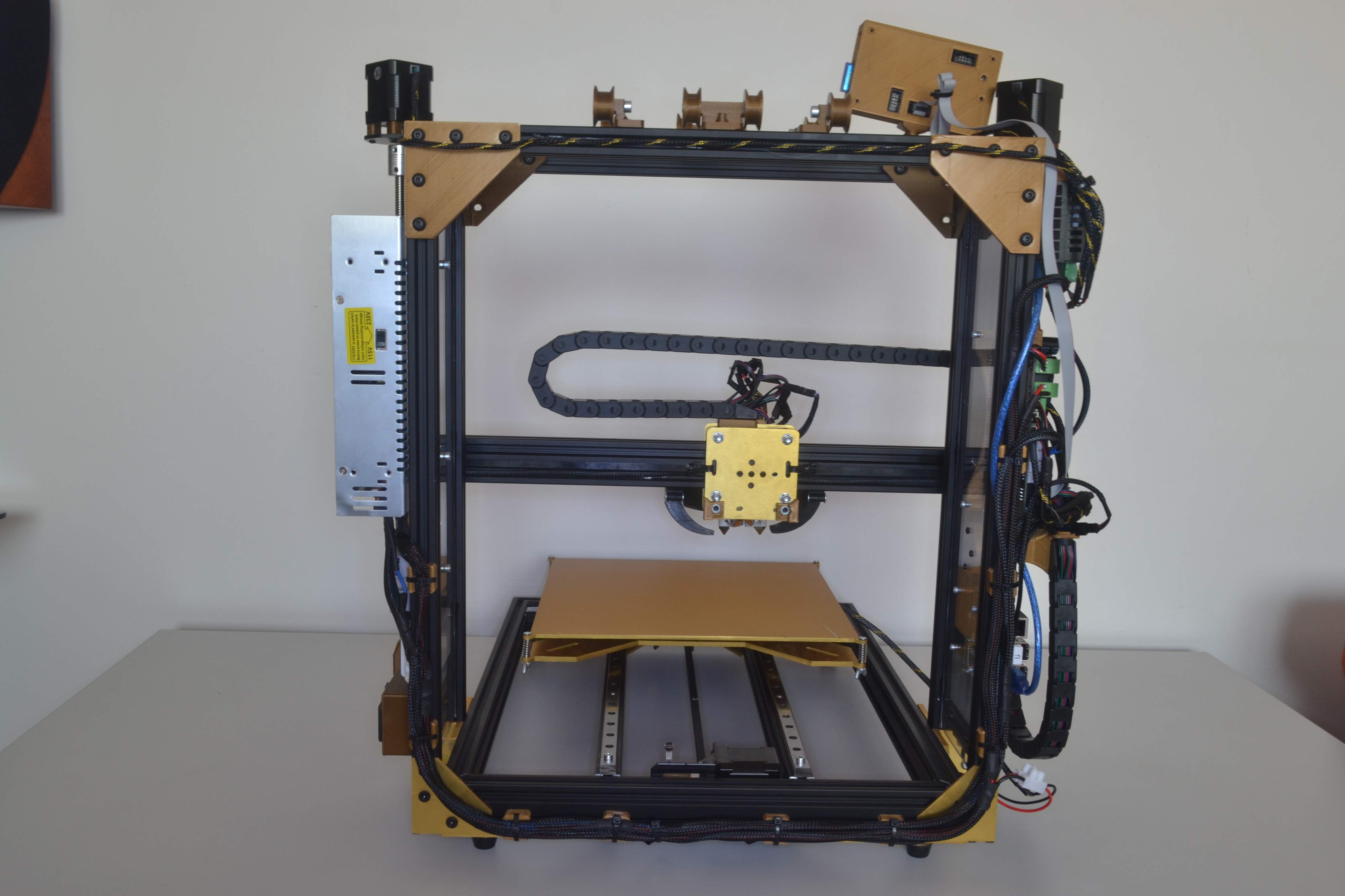

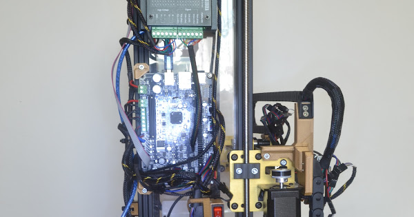

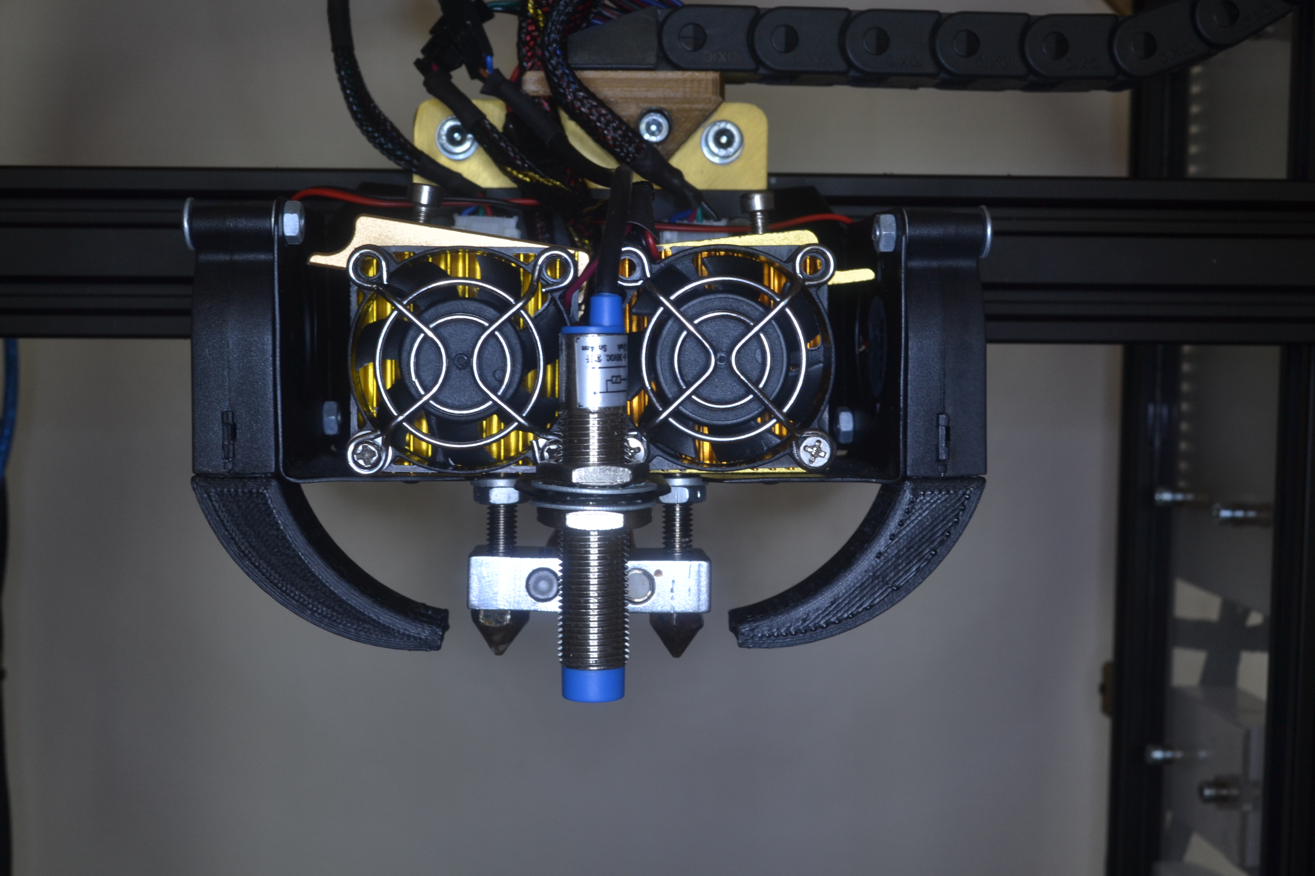

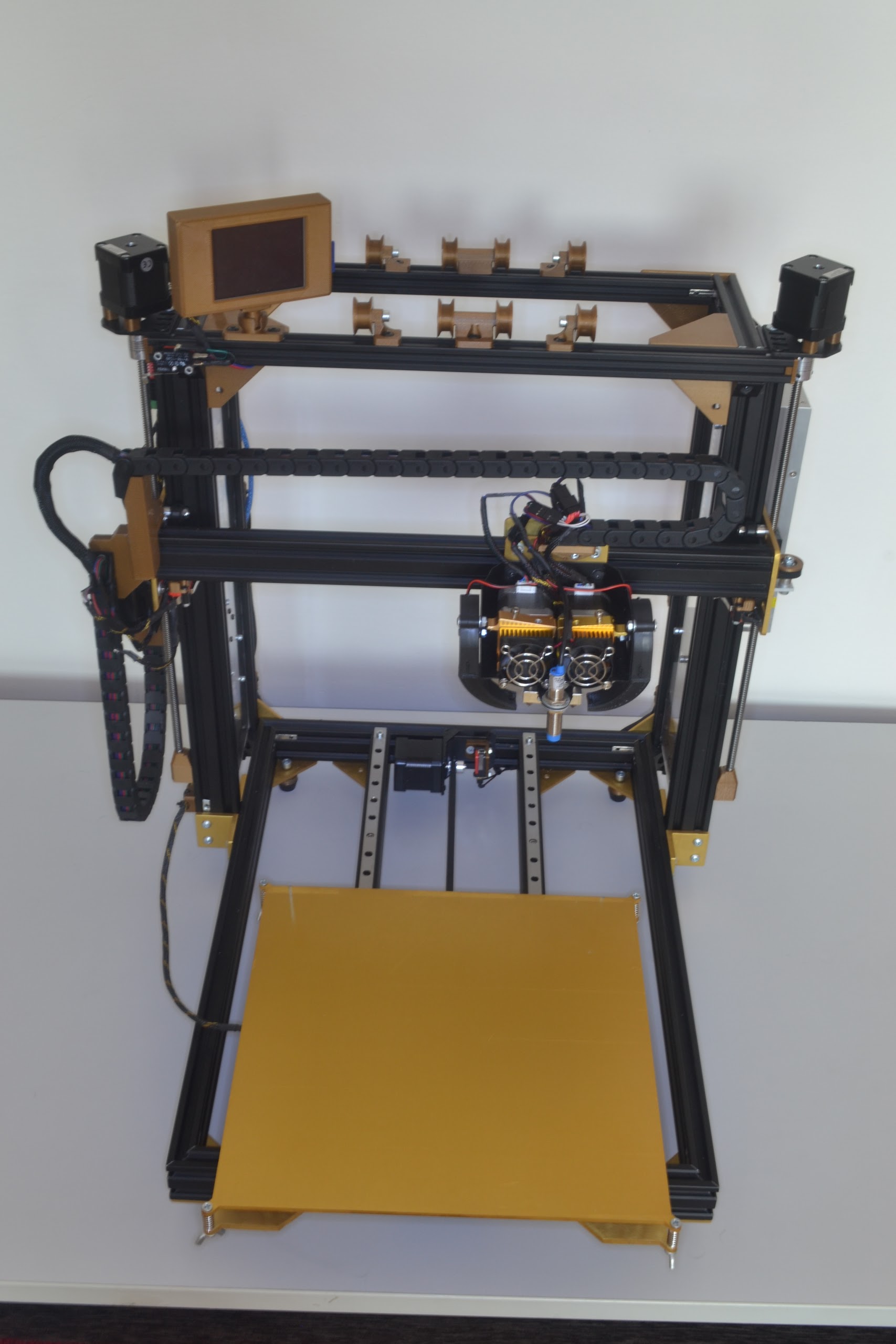

I build custom printer from alu v-slots and custom cutted alu plates. Build space is 300x300x300 mm, I will use dual extruder configuration. Bed is heated and control ensures mks sbase 1.2. I used tens of meters of wires, most of them sleeved, more like 100 custom printed parts, nearly 40 electrical components and it holds together around 450 screws and nuts.
