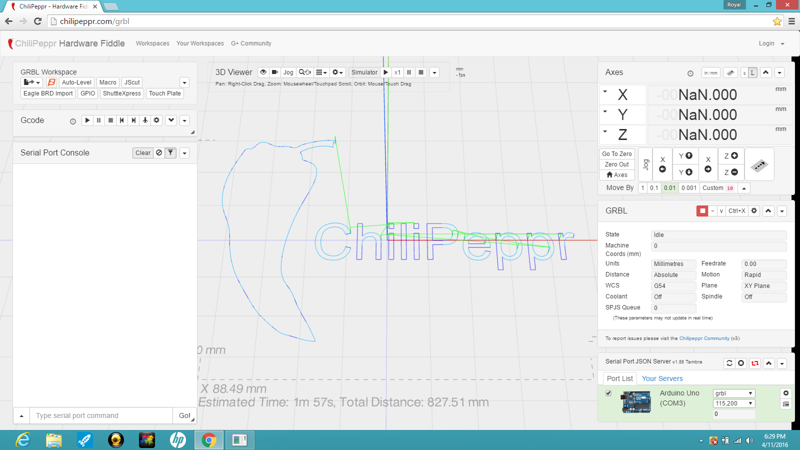

Hello. I built a grbl/arduino controlled cnc machine and I’m using Chilipeppr as my gcode sender. I believe I have completed all the steps to build the machine, but I have run into an error. I have attached a screenshot of my grbl page. My Arduino has grbl installed, the drivers and shield are hooked up and they have power, json server is running, the machine status says “idle,” but the x, y, and z axes display “NaN.000.” The machine is also unresponsive when I try to send any gcode to it. I googled for an answer but was unable to find one. Any help is much appreciated!

Well, I’m looking for the status updates. I bet you’re getting the wrong format or something and thus the parsing isn’t working and then it’s why you get “NaN” in the Axes widget.

Hello again. I bought a new arduino which seems to have fixed the problem I was having. I no longer get the “NaN.000” message. In fact, I get no errors! Everything seems to be going smoothly, but my router is still not moving :(. I can’t see what could possibly be going wrong. The cnc shield is getting power, the drivers are installed correctly, chilipeppr looks perfect. I try to move the axes with the arrows and it doesn’t move. I am really confused as to what is going on here. @jlauer
