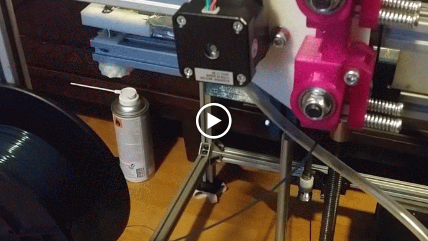

Hello. I had not much time for my new 3D printer, but I made a few updates yet. Printing volume is 330x330x390 (I have 405mm lead screws).My printer have Azteeg x5 mini, E3D volcano. The XY printer’s mechanics are more stable and shake not so much now. I’m experimenting with double Wade extruder and have a question Bond Tech extruder is good enough?
Flex3drive would rock
If you want problem free extrusion without slipping, grinding and with a huge force the answer is yes @Ivans_Nabereznihs .
Love the quiet movement. There’s a high pitch after the pump turned on. Is it due to air exiting the hood?
Yes, I got an air pump that is not so quiet. A new one is on its way to me. All stepper motors on my printer attached by rubber damper and they do not sound so high. Quietness and speed are important parameter for me.
@Ivans_Nabereznihs If you want speed, increased control resolution with precise retraction control in a direct drive extruder head weighing in at 70 grammes, Flex3Drive might be worth a look into
Youll certainly be able to stretch the limits of your machine with it. Nice build there too.
Yeah, but maybe it is possible to combine BondTech and Flex3Drive extruders and it becomes a monster extruder
A Flex3BondusRex or a BondusFex3Rex ?? ;p
