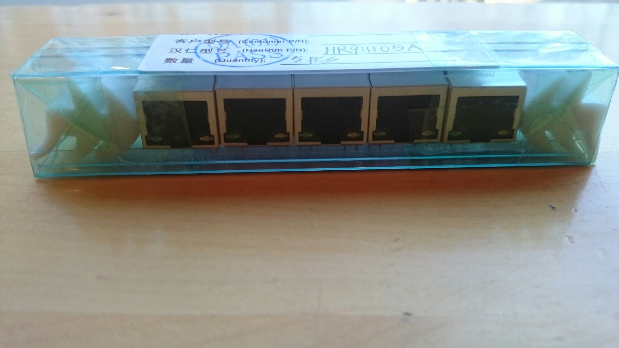

So Santa has a suprice for me this year, I e-mailed Hanrun and they will send me some samples. I will forward them to you Arthur so you can put them to use where they are most needed.
Happy Christmas
Wow, I most say, thank you Hanrun! My samples arrived today with DHL. Now to find someone that can solder it in for me, this and th 5v DC /DC converter.
