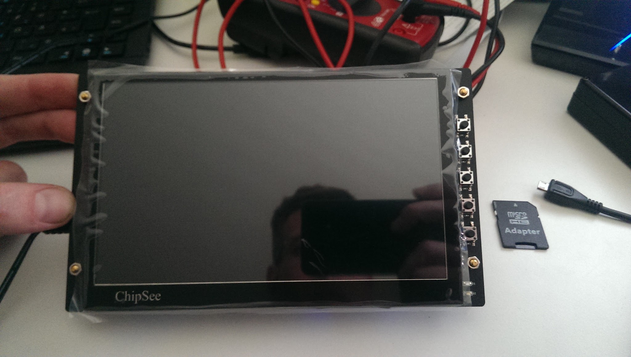

I have since today the ChipSee 7 “LCD touch cape, but not working! why? testet with Debian 7 + LXDE from Nand and Android 4.2 from mSD Card, both not working.
I have a 4,3” touchscreen to, both working with this LCD, Debian and Android without Problem.
The blue LED from 7" is minimal on.
can someone give me tips to solved?
You need to use the image that supports the ChipSee LCD. They use a custom image that is tweaked to provide custom drivers for the product. Should be included with the product.
many thanks for the quick reply, I’m going to try the attached img.
