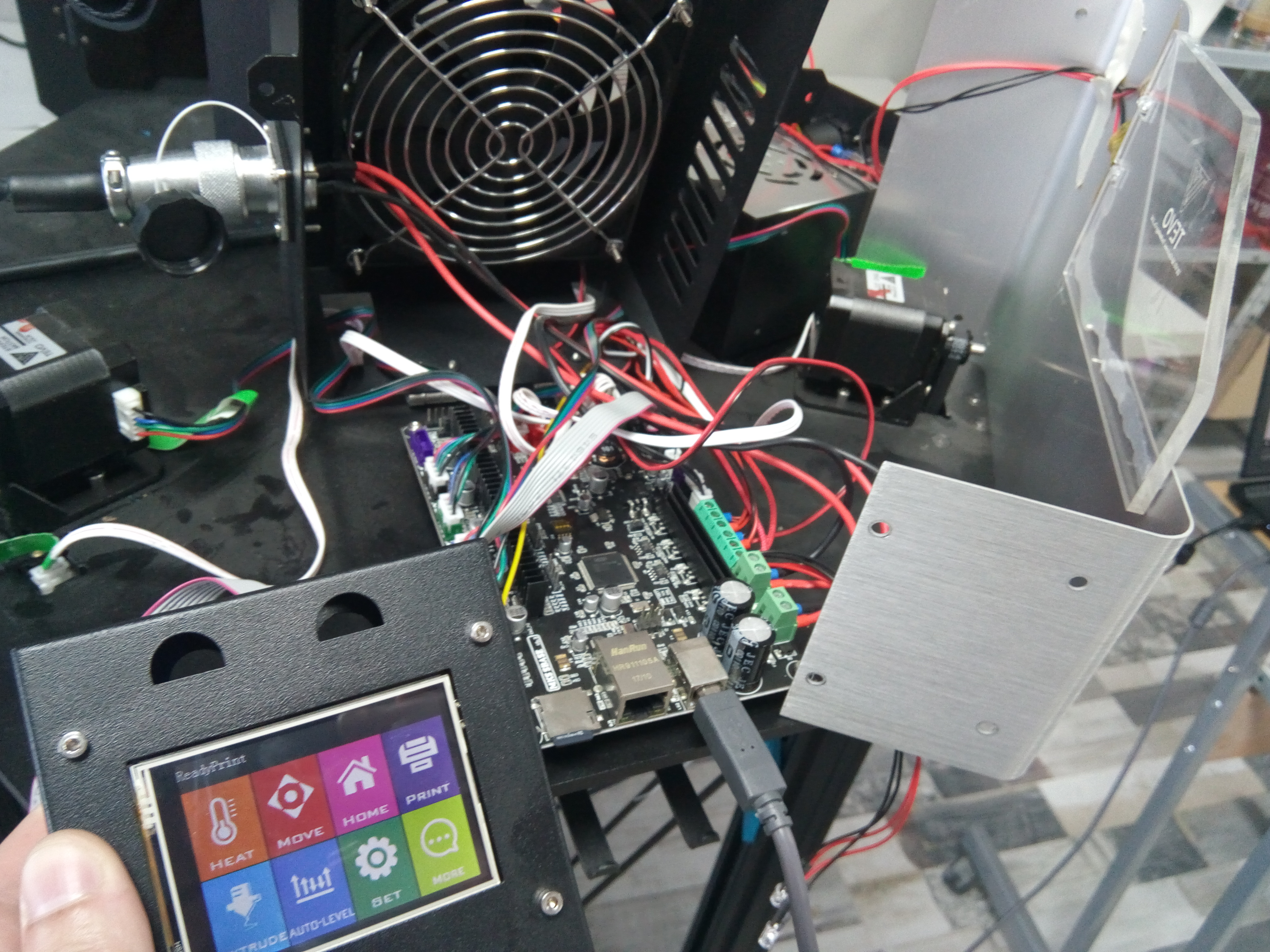

Hello, i have a strage issue with tevo delta little monster. There is no voltage for the motors, heaters, leds from the gray cover are off and the fan is not spinning. can any one help?
https://www.youtube.com/watch?v=SfvHhmL5qlo is similar with this video but mine do not fliker the leds near the name mks sboard v1.3 logo
i have checked the fuse and it is good. i have 24volts at mks base but at all other conections such as fan there is no voltage. that huge fan sould spin all the time and its not. i have checked all connection from power supply and its ok, i checked the solid state drive and its ok. I am runnig out of sollutions. PS.not even one led is on mks board when powered.

@David_Sherwood i did all of this, there is 24v at the mks board, thats why the screen works, i did even check the solid state relay and seems good. i think the mother board its dead but i’ll whait a little bit to change it and see if that its the problem. thanks for comment
hi, the LCD will work even the MKS base is dead. but am sure is not… do you upload the firmware in the MKS base? do you set the com port for communication? te pot ajuta si mai mult daca nu reusesti.

@Ciprian_Balalau_Make thank you verry much for you’re help. In conclusion the MKS SBASE was DEAD
